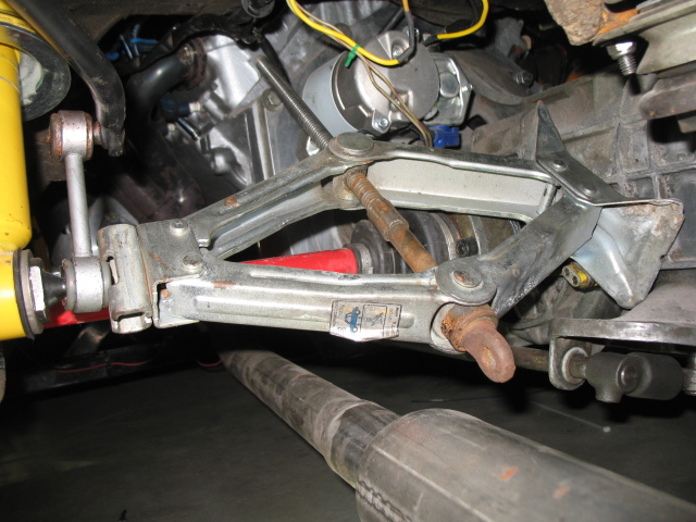

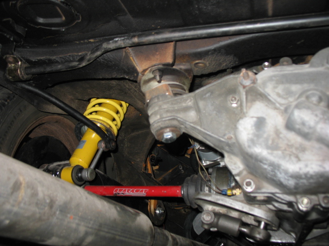

i had temporarily removed my rear sway bar so I can mess with my rear shocks.
a c clamp got the bushings back on the bar with ease but it took a scissor jack between trans and shock bolt to get them back together, with ease also.
