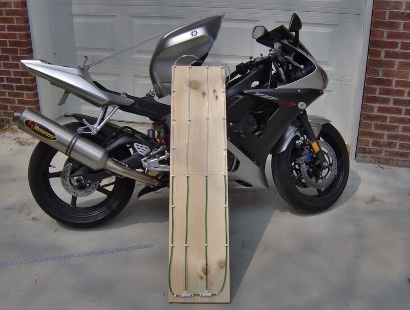

02loftsmoor   I used Mercury Sticks to balance my Motor cycle ca...   Nov 17 2013, 08:11 PM
