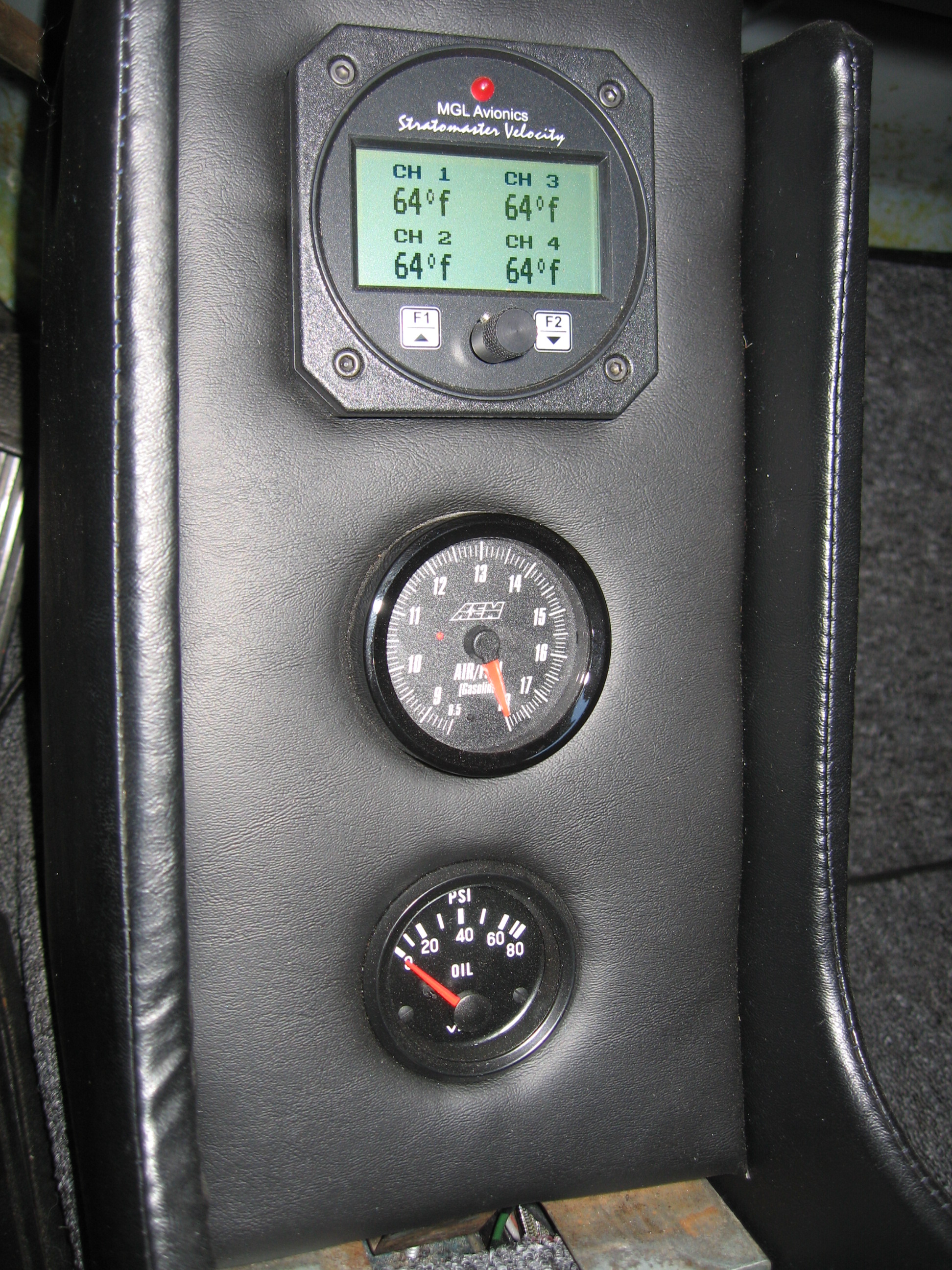

ww914
post Nov 17 2013, 09:00 AM
914 Convert
Posts: 435
Joined: 29-September 11
From: Central Coast, CA
Member No.: 13,621
I love gauges. The more the merrier, but I m running out of room. Good work Mark!
