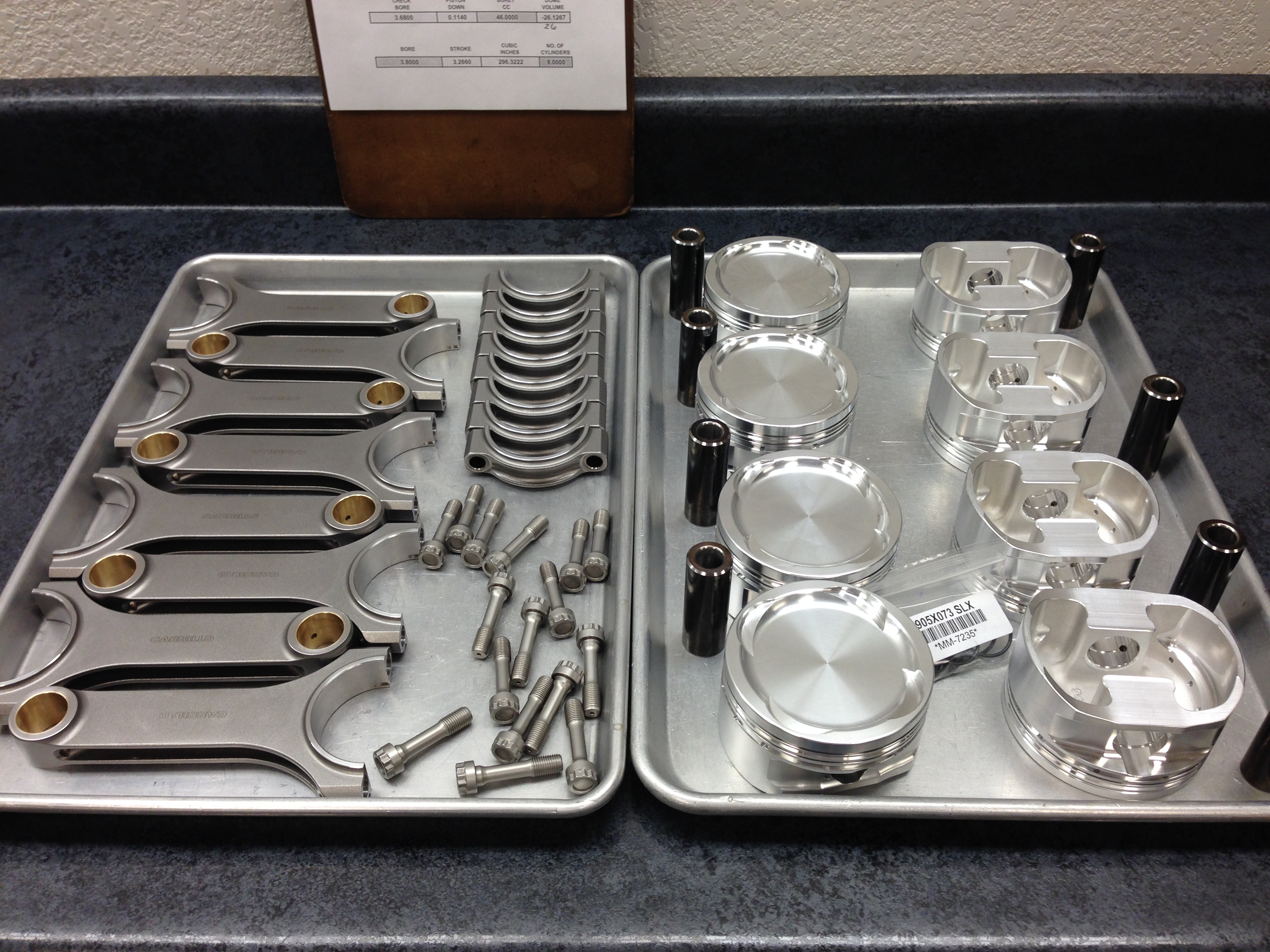

Pistons, rods + hardware arrived. Attached Image

Maltese Falcon   Pistons, rods + hardware arrived.   Nov 17 2013, 03:37 PM
Maltese Falcon   8.5:1 cr, 5.0L displacement, Carrillo mfg.   Nov 17 2013, 03:42 PM
Woody   :drooley:   Nov 17 2013, 05:22 PM
Mike Bellis   Marty, Any special coating for the pistons?   Nov 17 2013, 05:32 PM
Maltese Falcon   Marty, Any special coating for the pistons? I...   Nov 18 2013, 01:20 AM
