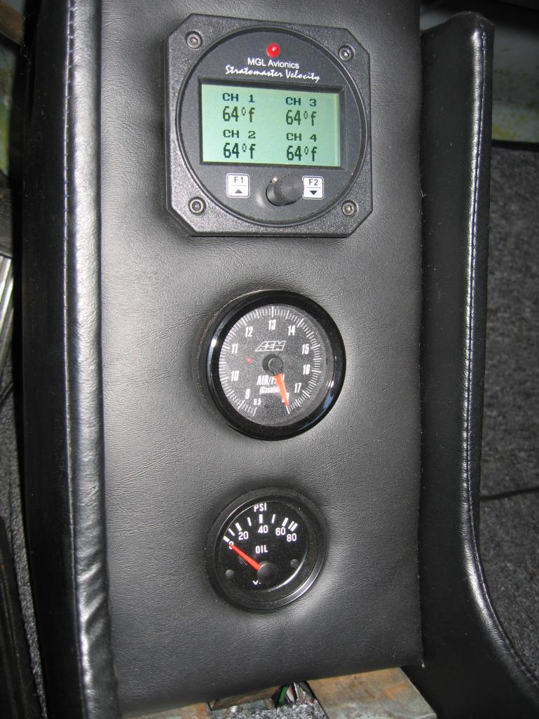

I love gauges. The more the merrier, but I m running out of room. Good work Mark!
Are those 4 temp readings air intake temps?

ww914   No they are aircraft cylinder head temps gauges wi...   Nov 19 2013, 08:24 AM
