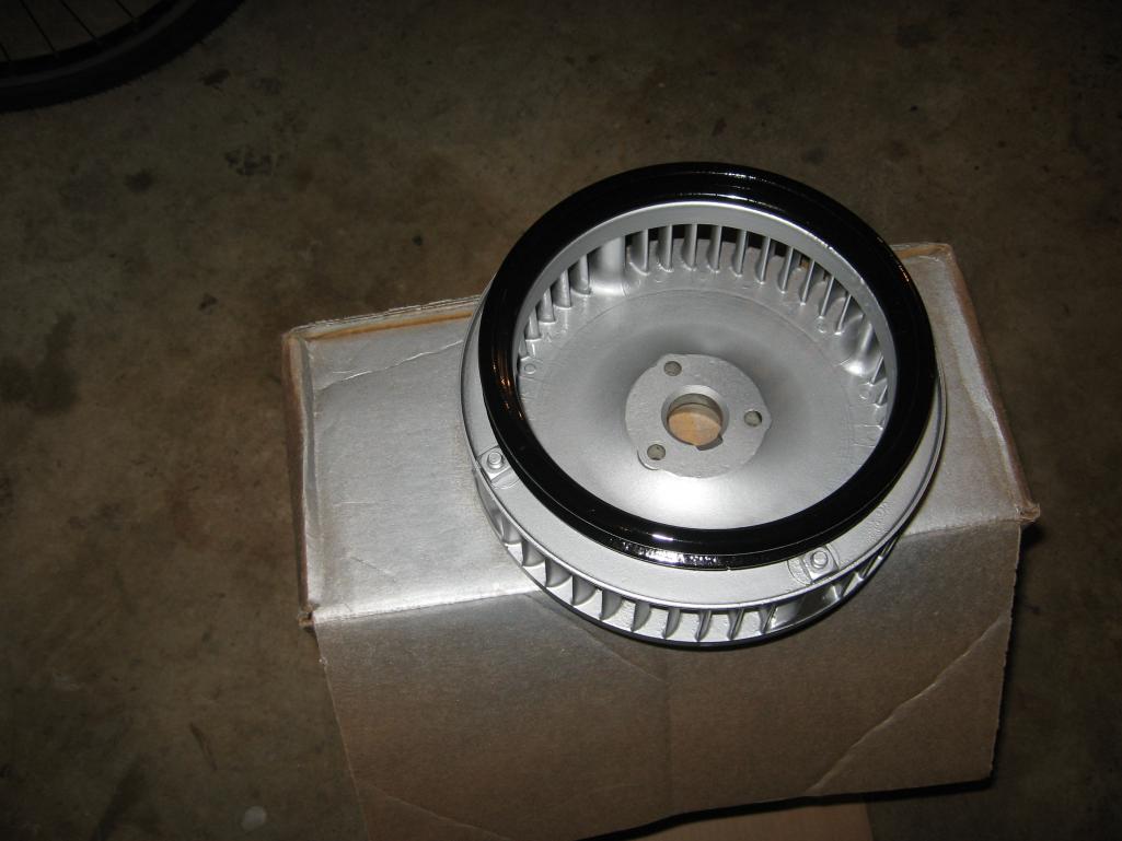

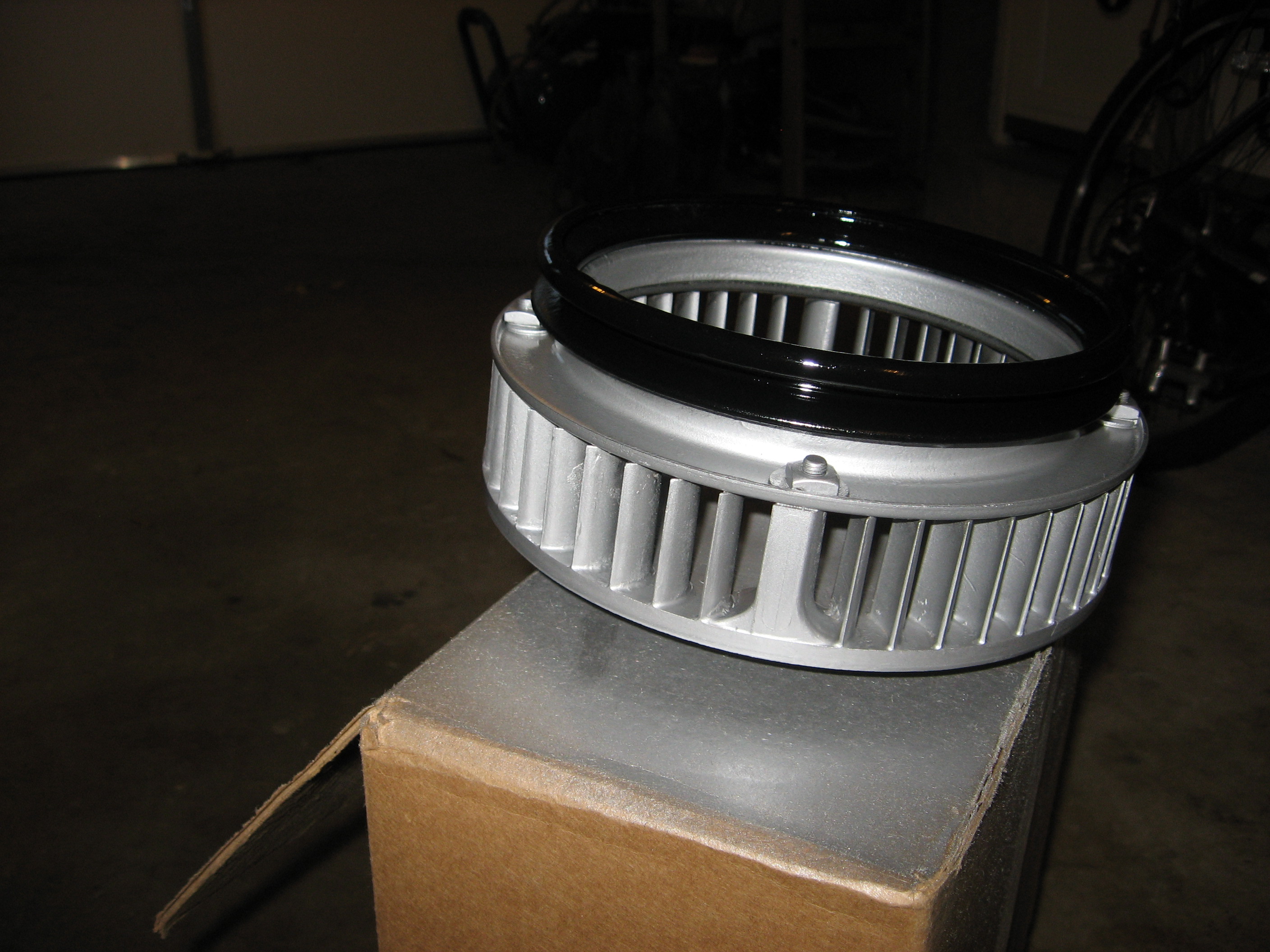

And the fan is finished being blasted and painted. The pulley metal was very rusty so I removed the rust, and between wirebrush, sandpaper and a grinding stone on my dremel and smoothed it down to metal as good as possible, then used Eastwood Rust encapsulator once that cured for a couple days, I topcoated with PJ1 case paint. After curing for 2 days I then baked it at 200 for an hour to fully cure and complete the ceramic hardening. Then painted fan housing with silver and baked. Tomorrow I hope to pick up my crankshaft remount the front bearings and gears and get back to the mechanic for balancing with all the parts.Attached Image

euro911   Nice. I can already tell how the rest of the motor...   Nov 19 2013, 08:14 PM
