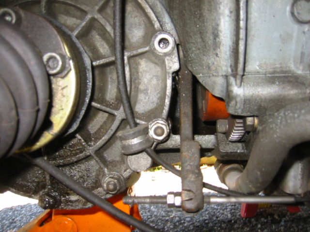

Howard, here is the setup in my car, it is a 2.2 clutch fork, the clutch cable is custom made by a local marina (they make the cable etc for sailboats)
I had to make a little aluminum standoff and spotface in the bell housing to get the fork located properly.... Ill dig out the stuff if I get a chance, and take a pic

Howard R   I'm in the process of changing from the standa...   Jul 27 2004, 08:03 PM

Howard R   Because I have already got the 915 flywheel and al...   Jul 27 2004, 08:21 PM
Howard R   Thanks Tim. Did you have to move the pivot and wh...   Jul 27 2004, 08:26 PM
TimT   Used a 2.2 ball, the pivot has to be moved a bit.....   Jul 27 2004, 08:33 PM
