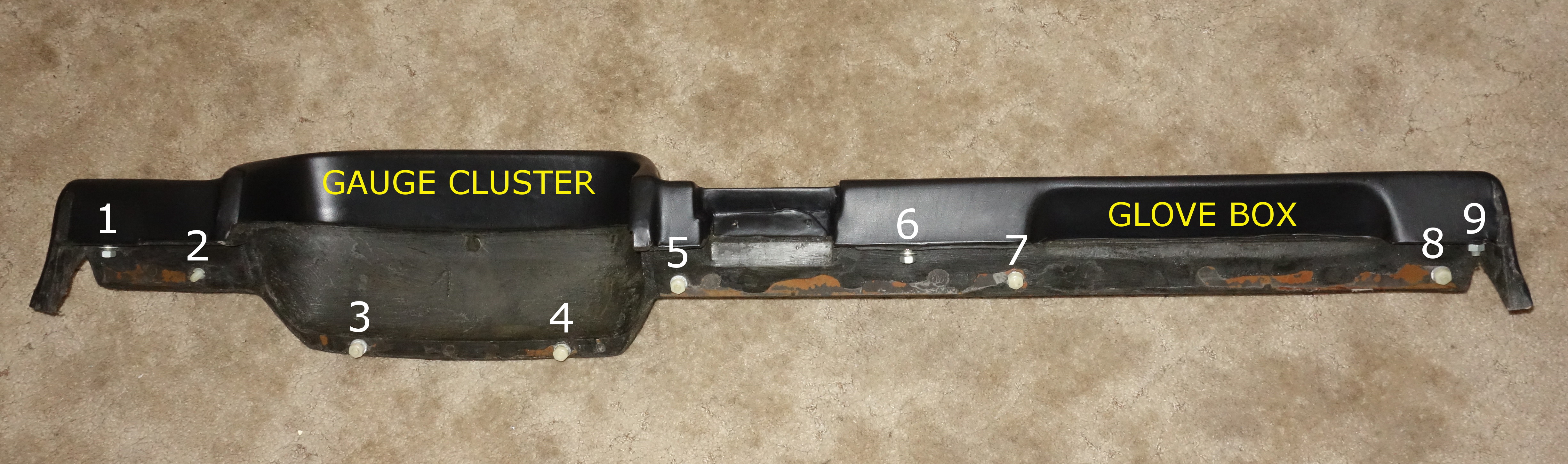

I agree with both the good Doc and Ruby ...... it isn't hard in the sense that you're simply unscrewing 9 nuts, but getting to those nuts is definitely a PITA. Some of the nuts (i.e., numbers 3 & 4 in the picture below) will seem impossible to reach, but patience, persistence, and the right tools should eventually enable you to prevail. I found that a knurled finger ratchet and a mini swivel head ratchet made the job a lot easier.
BTW, if your dash has never been touched since it left the factory, some of the nuts should be metal. In the picture below the metal nuts are #1, #6, & #9 but I can't recall if this is right, or if "3" is even the correct number of metal nuts. When you redo your dash, I recommend you make note of which ones are metal and replace accordingly.
