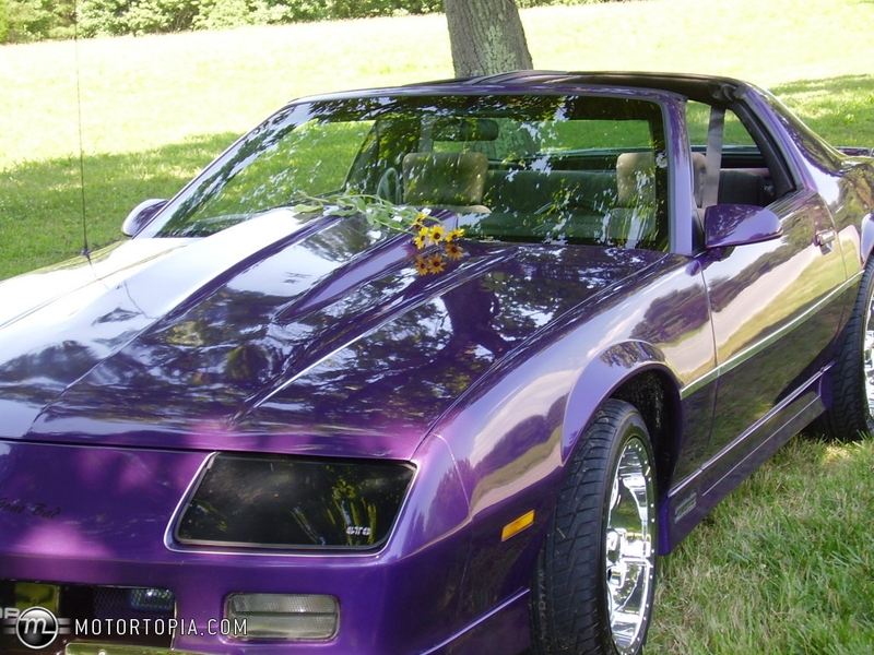

Another option I though of, but never pursued, was to find the correct size rectangular sealed beam lamps, form a metal (or mold a fiberglass) housing that fits inside the OEM bucket.
It would have a flat section on the bottom running forward towards the bumper top, then cover the whole assembly with 1/8" clear lexan. The exposed parts of the bucket would be hidden by painting those areas on the back side of the lexan ... either black, or color matched to the body.
Picture something similar to the '82~'92 Camaro's headlights (IMG:style_emoticons/default/idea.gif)
