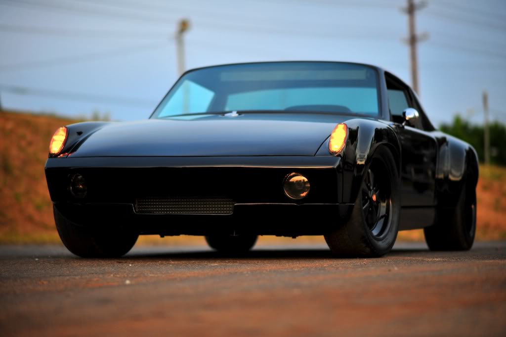

I have nothing to add .... I just like this picture!
(IMG:http://www.914world.com/bbs2/uploads_offsite/i1081.photobucket.com-12234-1385666760.1.jpg)
