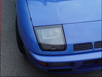

Not a fan of the dual round eyes myself, but the 944 guy's kit is more to what I had envisioned (IMG:style_emoticons/default/smile.gif)
Interested in tackling something like these, David? (IMG:style_emoticons/default/confused24.gif)

euro911   Not a fan of the dual round eyes myself, but the 9...   Nov 28 2013, 03:25 PM
dfelz   Not a fan of the dual round eyes myself, but the ...   Nov 28 2013, 04:01 PM
