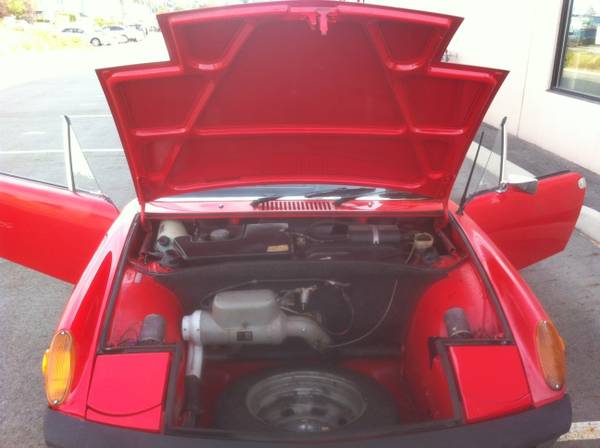

Did 914's and buses have gasoline heaters and if so where were they and how did they work?
Love to see a picture if anyone has one.

SirAndy   Webasto made a unit specifically for the 914 ... ...   Nov 20 2010, 12:13 PM

Mueller   Pictures as promised....pic 1 and 2 inside front t...   Oct 16 2015, 12:23 PM
Mueller   I found the installation manual for mine... Fuel:...   Oct 18 2015, 12:13 PM
Mueller   Need to find a low pressure fuel pump now.... Hook...   Oct 21 2015, 11:07 PM
