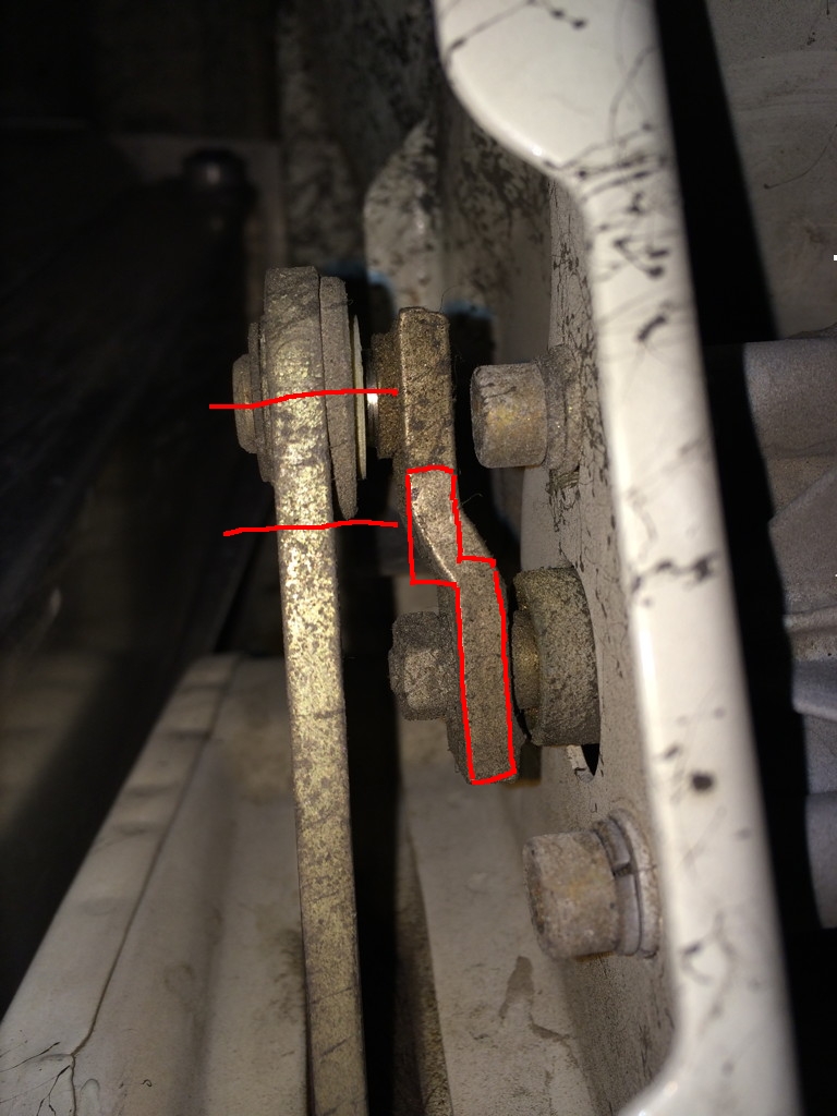

I think you've got it (IMG:style_emoticons/default/idea.gif)
It would take some experimentation, but shortening the actuating arm looks like it would do the trick.

euro911   I think you've got it :idea: It would take ...   Nov 30 2013, 07:22 AM
