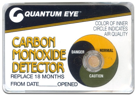

Perry K will pimp slap you for that idea (IMG:style_emoticons/default/biggrin.gif)
I've been thinking of doing the same on my /6, putting a box affair around the MSDS headers. I would agree with Perry it would be a bad idea as the mild steel tubes could rust out, but then the majority of us will never drive in the snow and salt .
If you were to try this I would for sure invest in this.
http://www.aircraftspruce.ca/catalog/pspag...clickkey=134504
