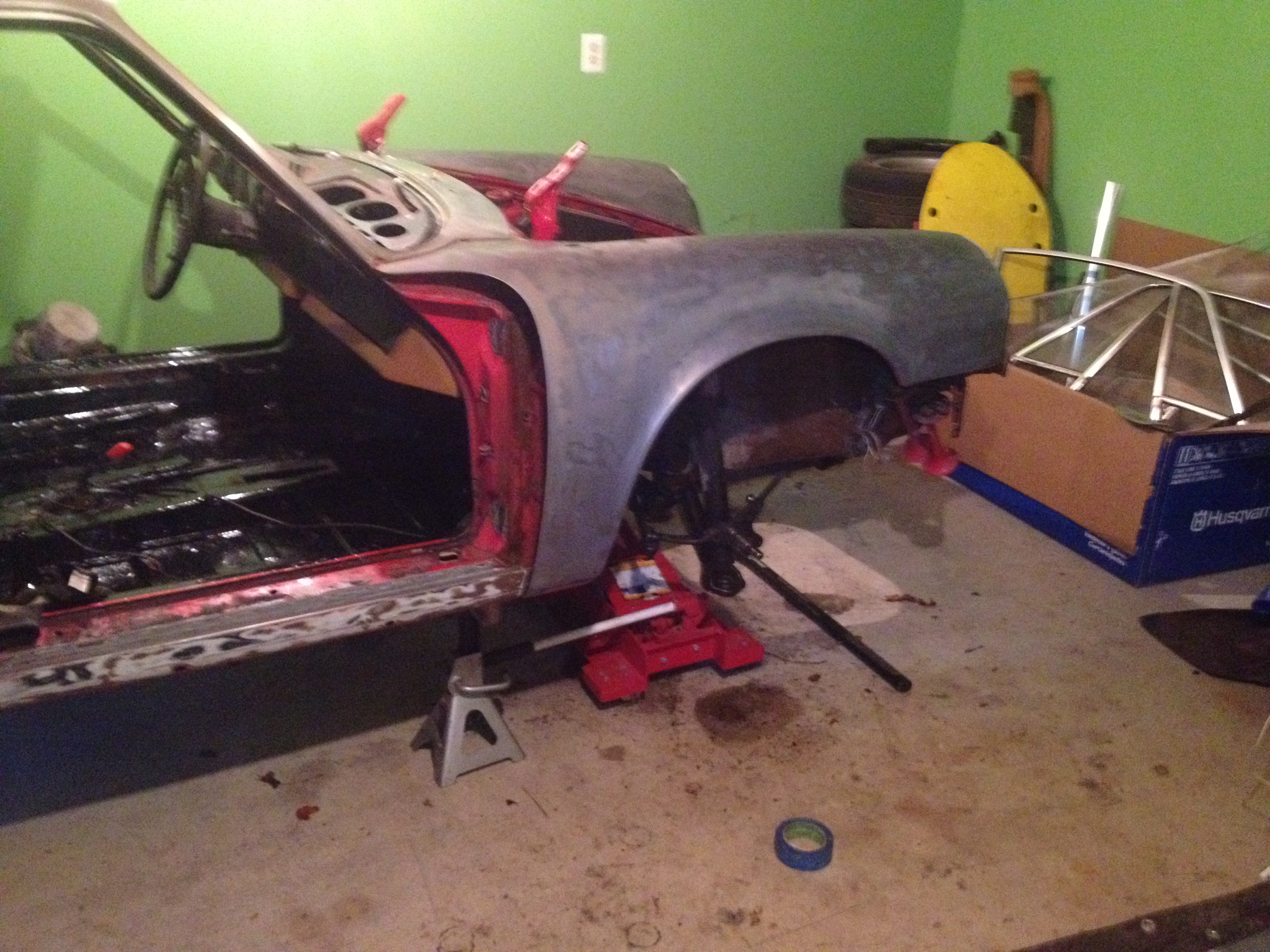

Some progress, I jacked the car up and put on stands today and started disassembling the suspension and brakes.
REAR: pulled the rear brake rotor, caliper, shock, brake shield and a few other things off the rear, was going to pull the rear spring plate and control arm bushings but after pulling the spring plate and looking at the bushing, which looked almost new, no cracks, etc. and some vigorous pushing and pulling of the control arm, I decided to lube and reinstalled. Nasty nasty rotors. I noticed the rear calipers were ATE.
FRONT: Pulled the rotors, calipers, shields, hubs, front sway bar, pulled out the torsion bars, and broke the balljoint pin loose, and ran out of energy (and the wifes patience lol ;-).
Notable moments: steel brake lines are shot, fittings are fubar, need to be replaced. Front torsion bars were in relatively good shape though the rear had no grease and had rusted. The brake pads were about 90% and caliper boots dont look too bad. Havent pulled the control arms off, but looking at the bushings they dont look dried out and cracked. I need to pull the control arms due to some rust on the arms and brackets. Will R&R the whole front suspension,
Next up: Separate the ball joint and strut housing, remove control arms and struts with camber plates, remove master cyl, drop the cross member and steering rack, clean and paint all, and then R&R.
