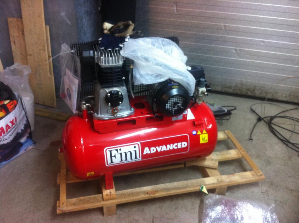

Didnt get much done this weekend, but I got my new compressor ! Finally I will have enough ooomph to mediablast smaller areas that are hard to get to with other tools.
