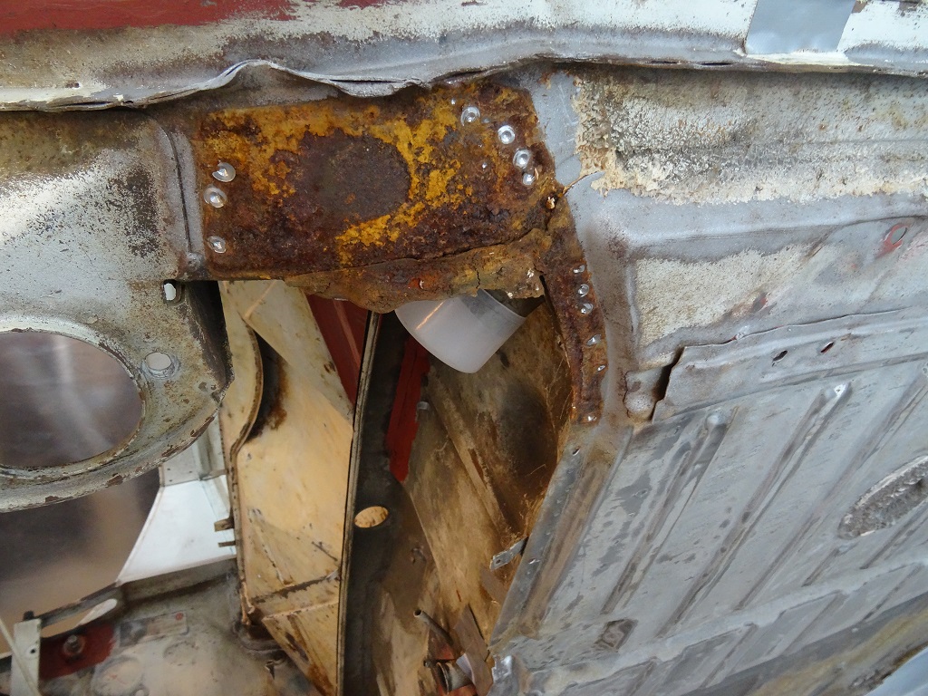

You can get the clips for the front windshield from 914rubber.com I believe. The square plastic pieces in the frame, if I am not mistaken are for an after market ski rack that was available back in the day.
As for the jack point, I think you can do without them if you don't want to put them back on. I personally don't have them on there, but my rockers also don't have holes stamped in them.(the perks of working at a metal stamping facility biggrin.gif )

Thanks for the info about the square plastic pieces Pete, I've been wondering about those for some time now. Today I've spend the morning mediablasting the "floor" under the headlightbuckets, had to build a longer blasting nozzle to get in there effectivly. Found some more rust but it's nothing to big.
And I've sent an order to Restoration Design for two new rear jack points and an E-brake guide panel.

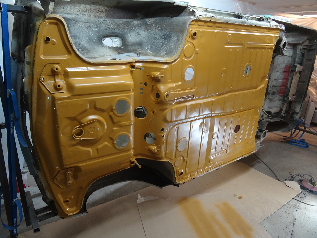

First paint has happened! Ok its only "B-surfaces" like trunks, engine compartment etc. but still...
IPB Image
IPB Image
IPB Image
IPB Image
IPB Image

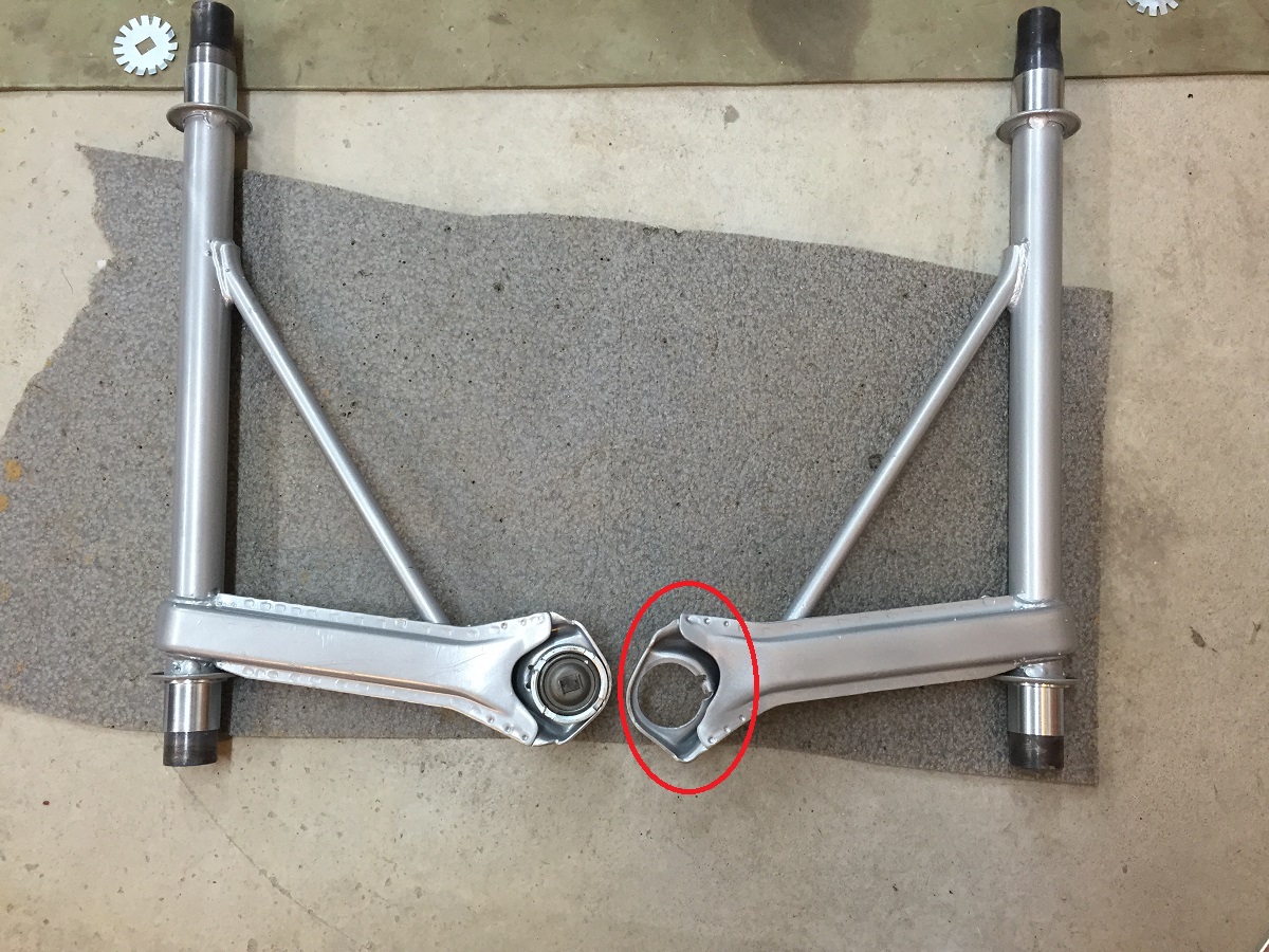

Glued the races for the front A-arm bushings on the A-arms on friday in preparation for
mounting the front suspension on saturday. Got the parts back from surface treatment
early saturday and proceded to mount the ball joints on the Aarms. Left went fine....right went....wtf is this!
Aaaah of course, another trace of the hit to the front right corner that some PO never fixed correctly. Getting another A-arm is managable, will cost me about $150 to get one and get it mediablasted and powdercoated. Sadly tho the bearing races are stuck to the old one and not coming off. I've emailed Elephant racing hoping to purchase a pair of loose races.
Annoyed with this I started on the rear suspension arms instead, drilled
and tapped the holes for the grease nipples, and my M6 thread tap broke off in the last hole.... I left Mr Murphy in the garage and called it a day at that point... dry.gif

New front right A-arm on the way from Germany and Elephant Racing are sending two new bearing races. Now I just need to squeese into the powdercoaters schedule
and get some paint on the new part.
