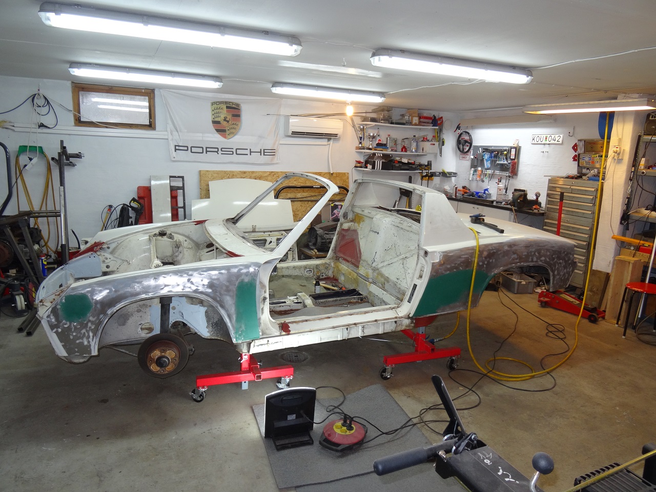

post Nov 25 2013, 12:23 AM
Posts: 1,579
Joined: 22-November 12
From: Sweden
Member No.: 15,176
Ok, it's been awhile since I wrote here. (IMG:style_emoticons/default/WTF.gif)
The car passed the Swedish registration after alot of hassles this spring, the "ex-California, export to Germany and then imported to Sweden" caused some greif and worries but it sorted itself out in the end thanks to help from the Swedish VW/Porsche group that helped with some brake certification documents. (IMG:style_emoticons/default/pray.gif)
Wasting no time me and a friend tore into the car, cataloging nuts and bolts and small parts in labeled zipbags and soon we had a bare shell.
The shell has been one trip to the bodyshop for some straightening och rust repair, I also had them weld in a rear suspension reinforcement kit from Tangerine.
Currently I'm working on the surface rust in the center tunnel and working my way outwards from there.
(IMG:http://www.914world.com/bbs2/uploads_offsite/matsgarage.com-15176-1385360592.1.JPG)
arkitect
post Nov 25 2013, 06:10 AM
Posts: 617
Joined: 3-March 10
From: Stockton, CA
Member No.: 11,426
Looks like a cool project. More pictures, please. (IMG:style_emoticons/default/biggrin.gif)
Dave
MMW
post Nov 25 2013, 06:59 AM
Posts: 152
Joined: 6-October 13
From: Northern NJ
Member No.: 16,477
Looks like you are doing a nice job. Can you post some pics of your car dolly? It looks interesting as I haven't seen one like it before.
cary
post Nov 25 2013, 07:28 AM
Posts: 3,900
Joined: 26-January 04
From: Sherwood Oregon
Member No.: 1,608
QUOTE(MMW @ Nov 25 2013, 04:59 AM) *
I was thinking the same thing .....................
naro914
post Nov 25 2013, 07:37 AM
Losing my mind...
Posts: 2,476
Joined: 26-May 06
From: Charlotte, NC
Member No.: 6,073
I was actually marveling how his garage in Sweden doing a restoration project looks just like all the garages here in the States doing a restoration project...some things don't change anywhere in the world you are!
Looks great!
saigon71
post Nov 25 2013, 07:50 AM
Posts: 2,032
Joined: 1-June 09
From: Dillsburg, PA
Member No.: 10,428
Looks like you are making some fine progress! (IMG:style_emoticons/default/beerchug.gif)
Take your time and do it right the first time, then just (IMG:style_emoticons/default/driving.gif) (IMG:style_emoticons/default/driving.gif) (IMG:style_emoticons/default/driving.gif)
rick 918-S
post Nov 25 2013, 08:31 AM
Hey nice rack! -Celette
Posts: 21,345
From: Now in Superior WI
Member No.: 43
I like that car dolly!
