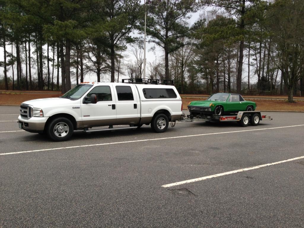

CptTripps   So I'm all ready to transport my 914 to the sa...   Jan 30 2014, 09:39 AM
Garold Shaffer   That will work. I would recommend that you enclose...   Jan 30 2014, 10:05 AM
wndsrfr   I'm searching Craigslist to find a trailer fo...   Jan 30 2014, 10:09 AM
CptTripps   Hmmmmm.....I'm going to guess that you are th...   Jan 30 2014, 10:27 AM
chads74   I would definitily go with a longer tandem axle tr...   Jan 30 2014, 10:31 AM
CptTripps   Just picked it up. It's got everything I need....   Jan 30 2014, 01:42 PM
r_towle   winch is too light weight, harbor freight. I woul...   Jan 30 2014, 01:47 PM
Garold Shaffer   Not bad. Since you have welding skills I would rec...   Jan 30 2014, 01:55 PM
CptTripps   Yeah...already ahead of you on the winch. Just got...   Jan 30 2014, 01:58 PM
r_towle   i got something similar...just the two ramps. I en...   Jan 30 2014, 02:12 PM
f1rocks   You did well for $400! If you do sandblas...   Jan 30 2014, 02:31 PM
euro911   Nice score :beer2:   Jan 30 2014, 02:32 PM
