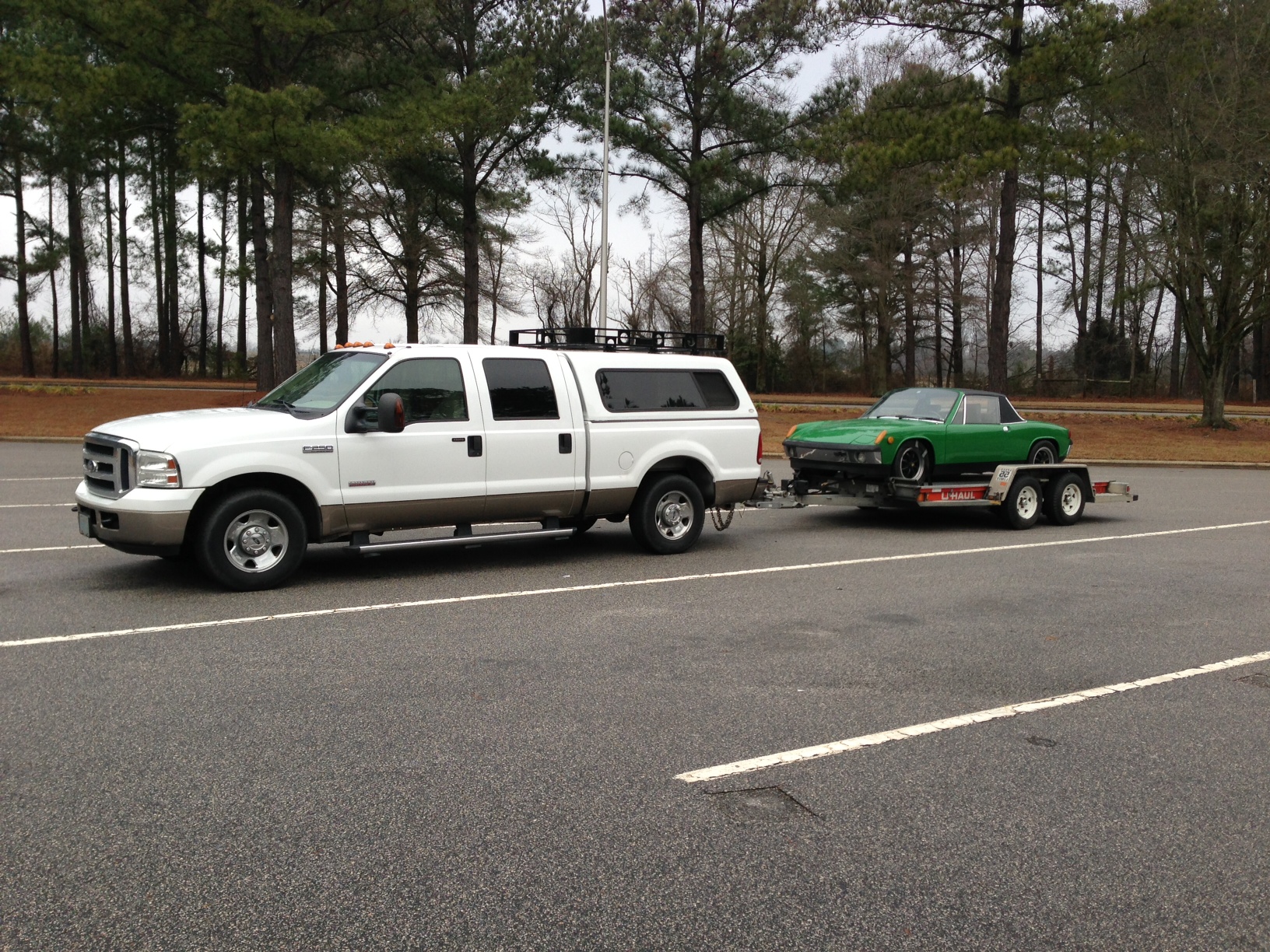

My trailer is the first one in the trailer thread
I built it, it has a 12' deck, 3500lb drop axle and 14" tires. The axle sets back from the centre it's made for VW's if you load it correctly the weight is centre on the axle with a tongue weight of say 50lbs.
I built it in 1990, it's the same tires and I've never once had a flat tire. The 1967 bus in the picture I bought in Manassas, Va and it came back to Canada on that trailer, in fact at least two times a year i would bring back a car from the US. Manassas in the summer (BugOut) and one from Florida in the winter.
The only real downside is it won't carry anything heavier than a VW westy, but seeing as I have never owned a full size pick-up, (VW busses and a smaller Toyota P/U) it's never been an issue. Having the wheels set back makes it track real good.
I can measure all the dimensions if you want them.
I should probably buy new tires for it some day.

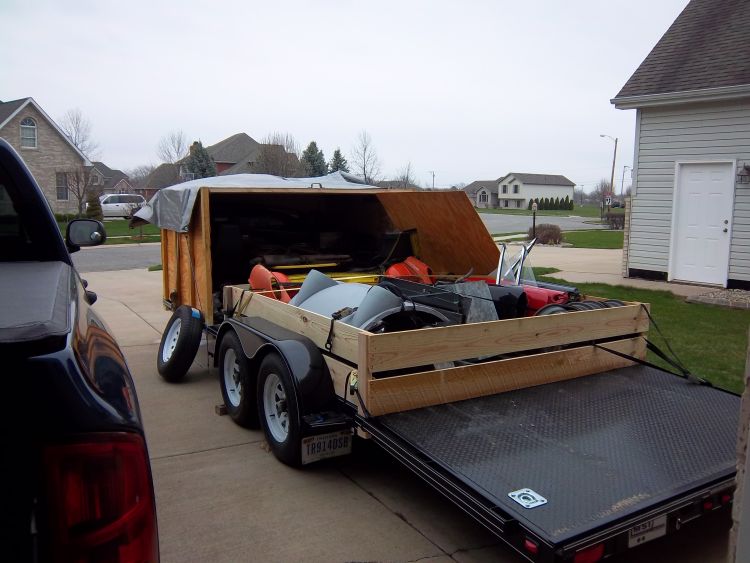

mikelsr

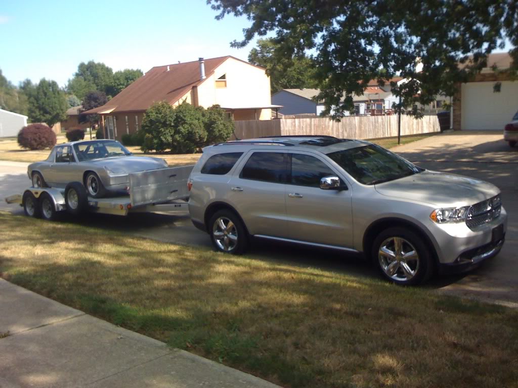

I've got an 18' tandem to carry my 914. I got a larger trailer so I can use it to pull other cars/trucks/etc. I also went with an aluminum trailer because of the weight.

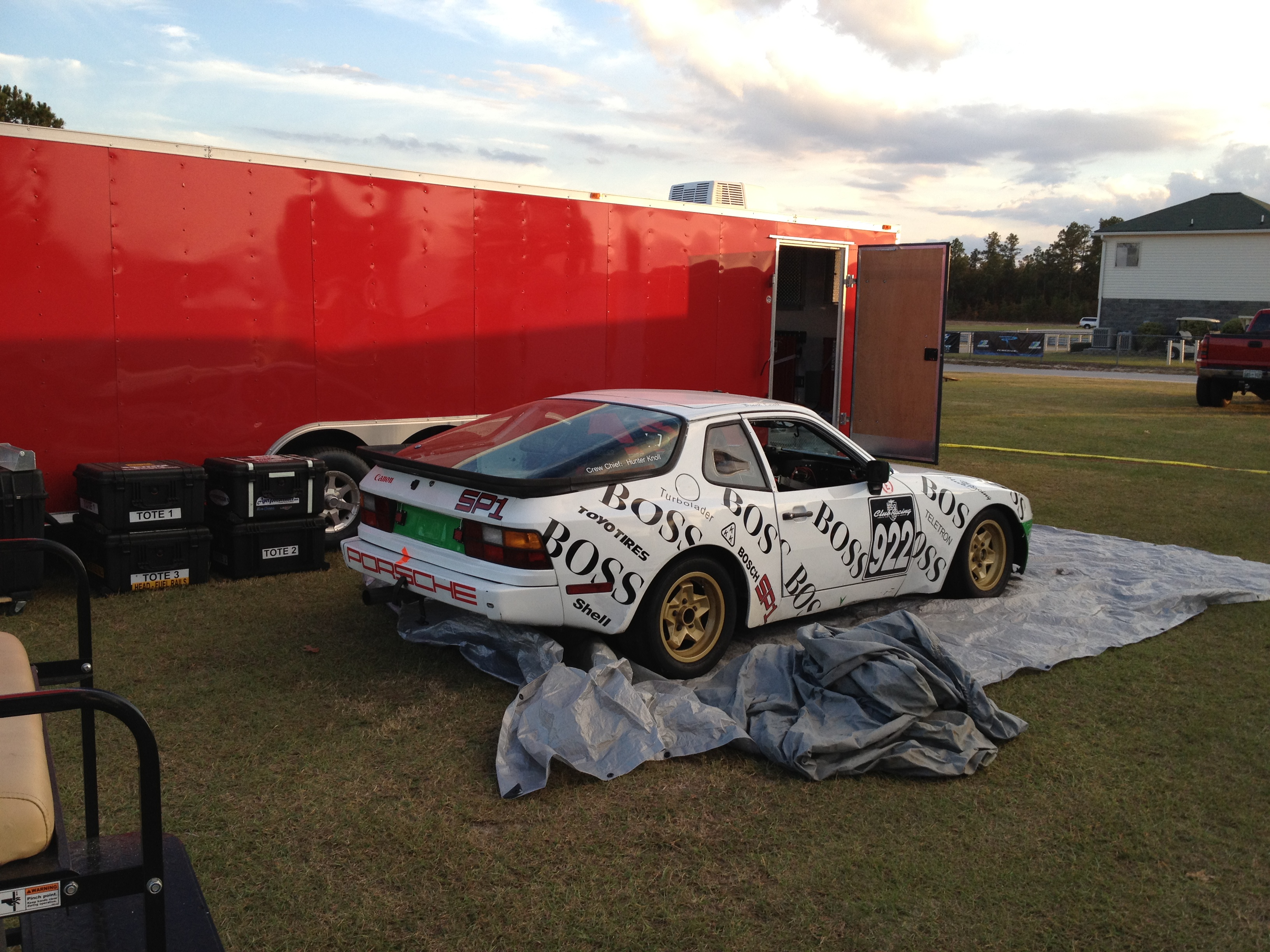

An enclosed trailer is nice but may be a little overkill for a 914. A nice open trailer with a dovetail back helps loading and unloading.
tandem axles is a must...trailer tires are not very good...tire pressure is critical to help keep them alive.
the good thing about the open trailer is the weight. My V nose 22' weighs about 3,500 lbs., about 7,500 with stuff and the Z06 in it. I get about 10 MPG when towing.

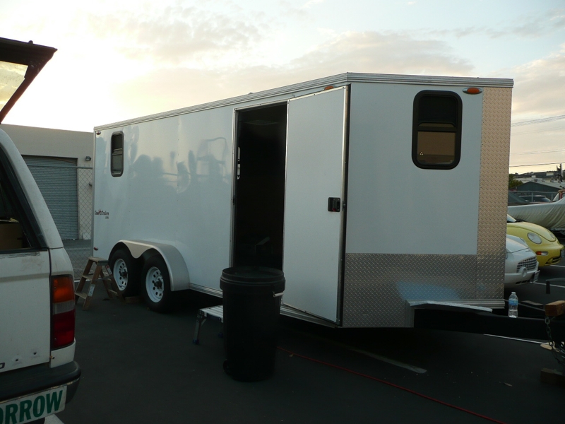

euro911

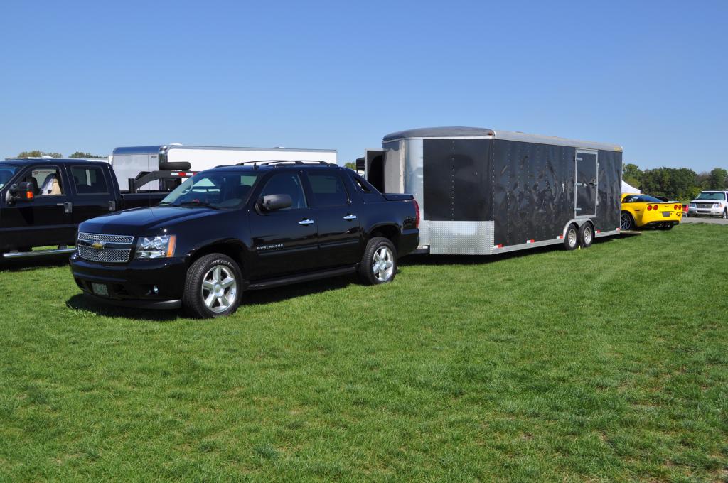

7 x 16 ft. box with 3 ft. v-nose. All the good things said above + it's a mobile garage/man cave and/or living quarters if need be. Can hauls a lot of cycles too smile.gif

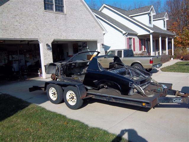

GaroldShaffer

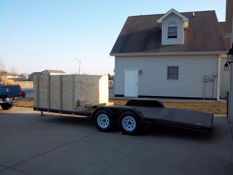

For 7 yrs I used this 16ft tandem axel steel deck dove tail to haul my car and the many parts cars I have picked up. It worked great, but was a little short me.
Finally this year I bought this 23 foot (deck is 20ft) tandem steel deck dove tail and I love it. I am able to haul many different size cars (and junk). I would recommend a tandem axle with brakes on both axels and get stake pockets. I like the ability to add sides (or a big box). A enclosed trailer would be nice, but for me at this time it doesn't fit my needs.

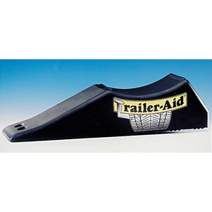

I would also recommend that if you get a tandem axle to also get on of these trailer aids and buy a socket that fits the trailer lug nuts and a big breaker bar.
