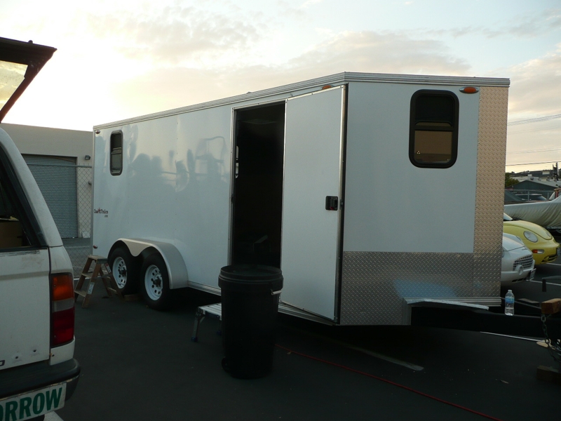

7 x 16 ft. box with 3 ft. v-nose. All the good things said above + it's a mobile garage/man cave and/or living quarters if need be. Can hauls a lot of cycles too (IMG:style_emoticons/default/smile.gif)
