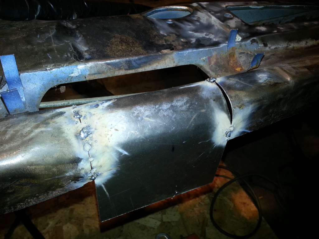

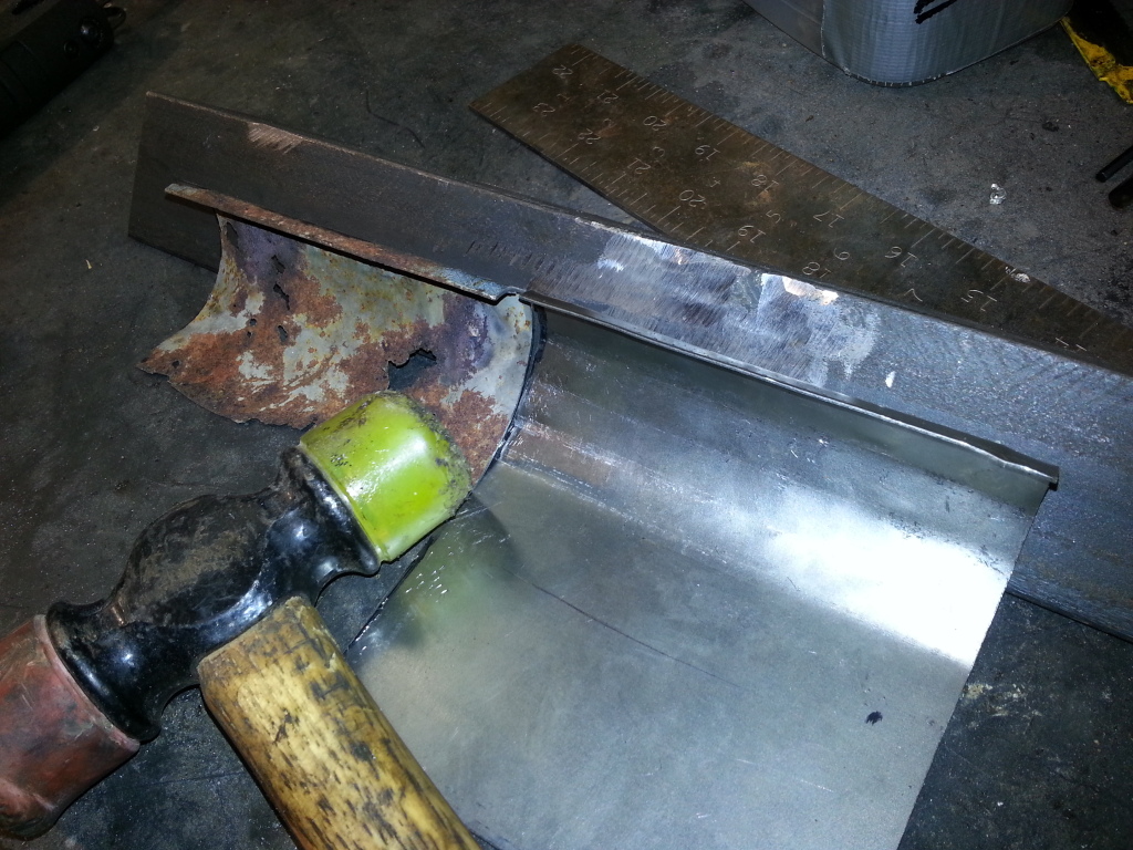

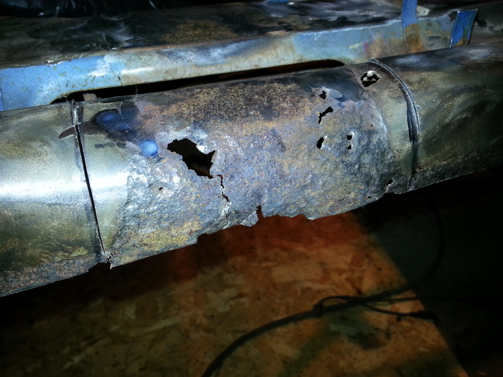

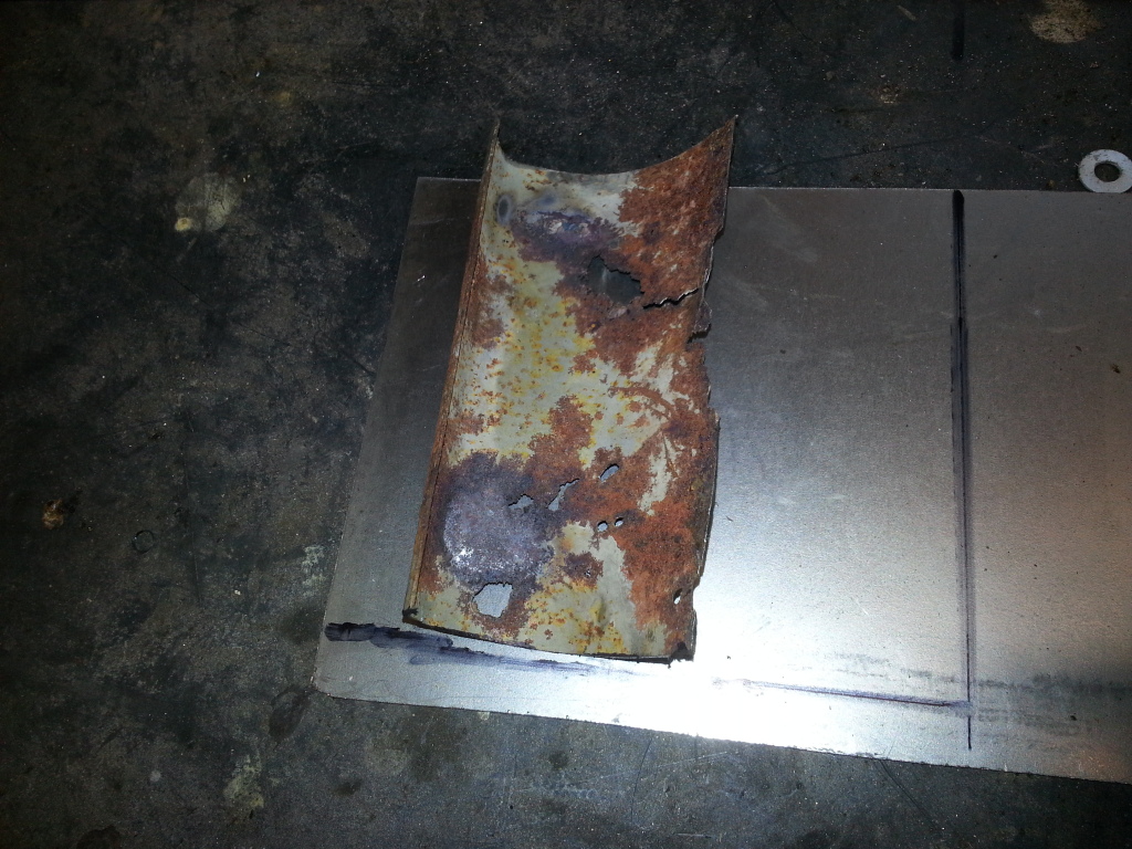

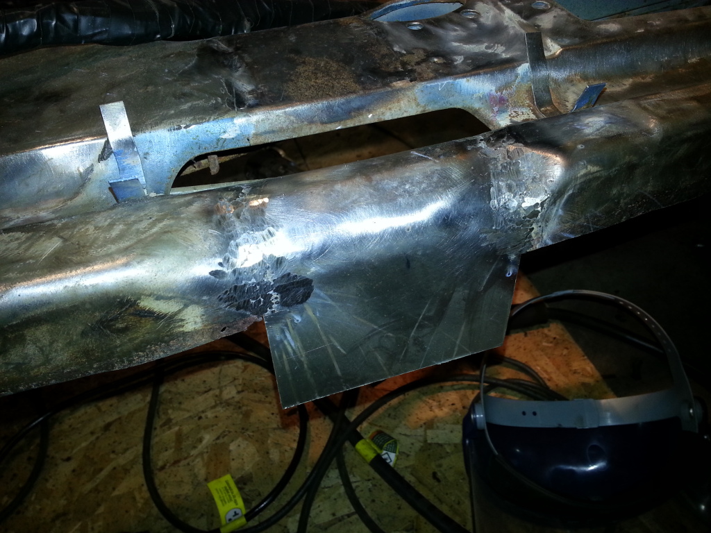

Another few hours of tunnel fun this afternoon. I decided, "What the heck?" and just cut the offending rust area out that was under the cross member. Being careful to not mangle the cut out section - I used that as a template for a patch. Bending the new sheet metal with a vise, nylon hammer and handy piece of angle iron. I got it as close as I could and then started welding it in using magnets under to hold it in place. On small area had a different bend but I was able to hammer the metal close enough to bridge. It's not pretty but everything will get rust kill and sealed with POR 15.
