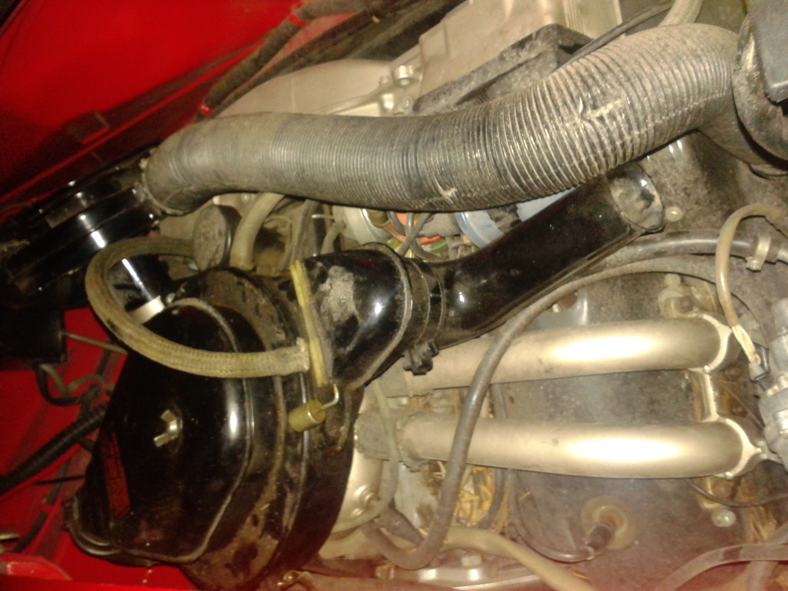

amcmackin1   Sorry for the head turning   Dec 5 2013, 09:28 PM

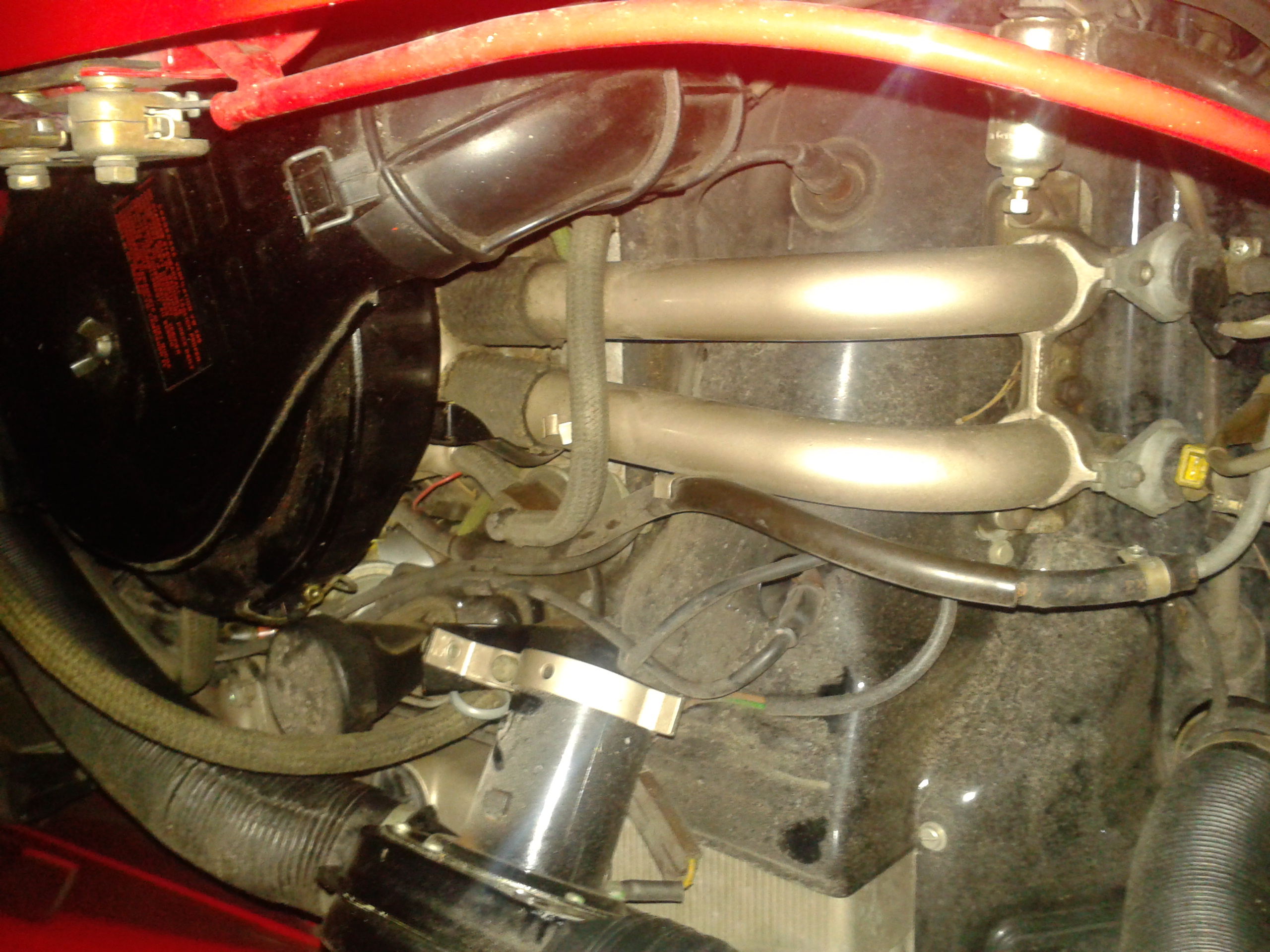

amcmackin1   final one   Dec 5 2013, 09:29 PM
euro911   Unless you've already corrected it, the inject...   Dec 5 2013, 09:50 PM

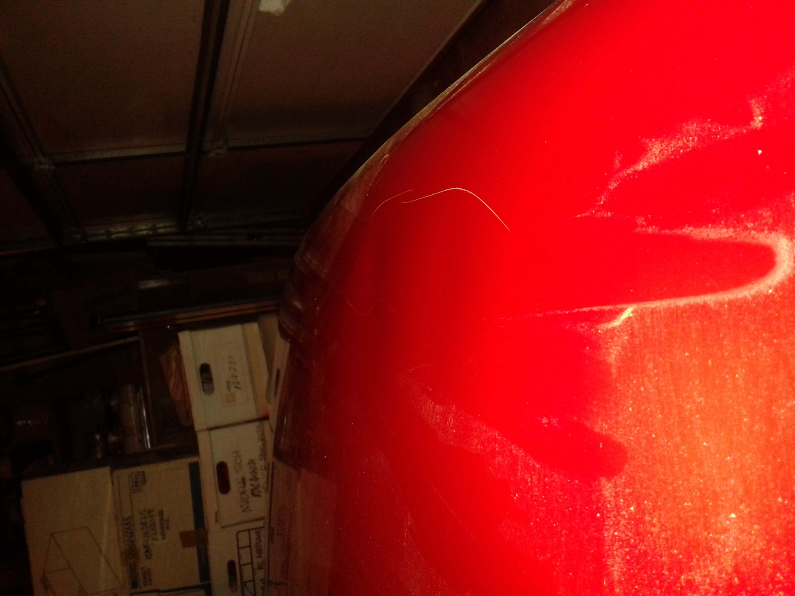

Ferg   Paintless dent guy can certainly take care of thos...   Dec 6 2013, 05:41 PM

jim_hoyland   Sounds like leaky air hose connections or hoses: t...   Dec 10 2013, 09:34 PM
amcmackin1   I would assume that the hoses are cut to the prope...   Dec 10 2013, 09:54 PM
euro911   Bite the bullet and replace all the vacuum hoses. ...   Dec 10 2013, 10:05 PM
rick 918-S   As others have posted. These cars need all the vac...   Dec 10 2013, 10:55 PM
