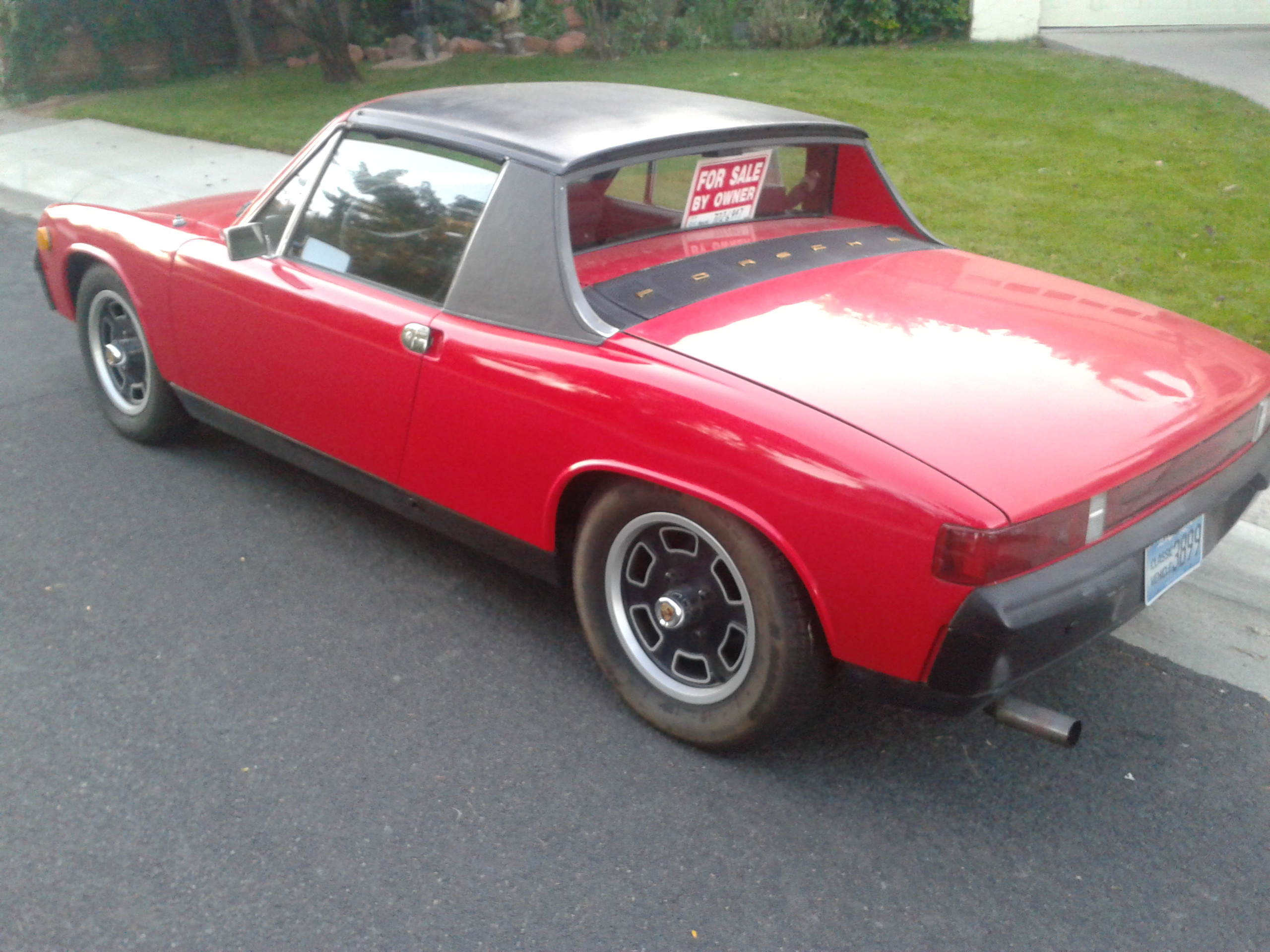

Hey guys I am new to the form, but i purchased a 914 about a month back. Its a clean Porsche with 24k miles on it, and it shows. But it has absolutely no power when it comes to hills, first gear or just period. barely makes it out of my driveway in reverse and it is not that steep. It has the 1.7L and i would like to get some more power out of it but not change it from original. Thanks to my county i don't have to smog it so that's not a problem but it was smogged by the original owner. Anyways its registered as a classic vehicle and only has one dent! (IMG:style_emoticons/default/ar15.gif) anyways Let me know what you think and If any one can help with the lack of power i would greatly appreciate it

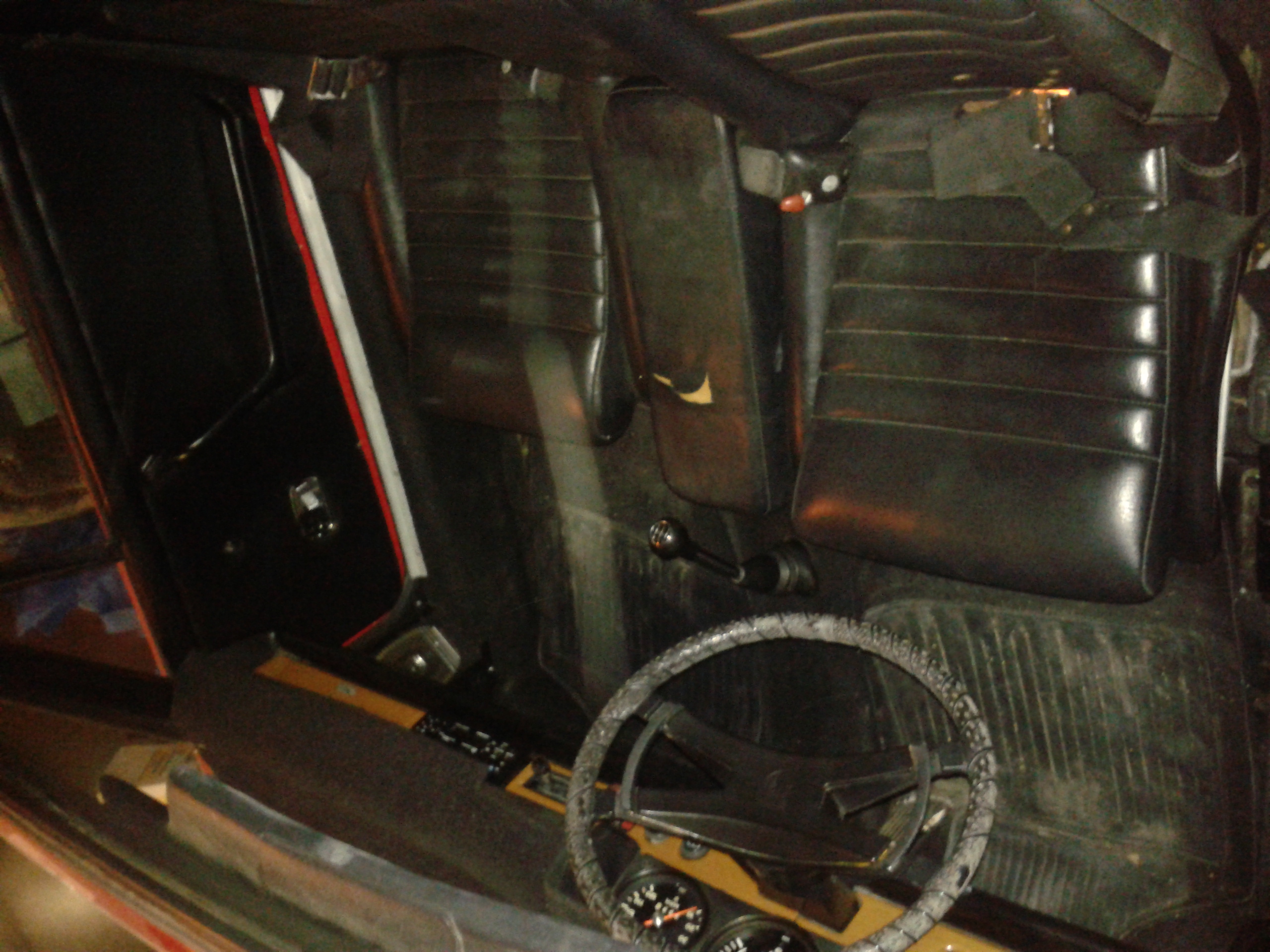

Ferg   Welcome, sure looks clean, how about some more pic...   Dec 3 2013, 11:48 AM

euro911   Unless you've already corrected it, the inject...   Dec 5 2013, 09:50 PM

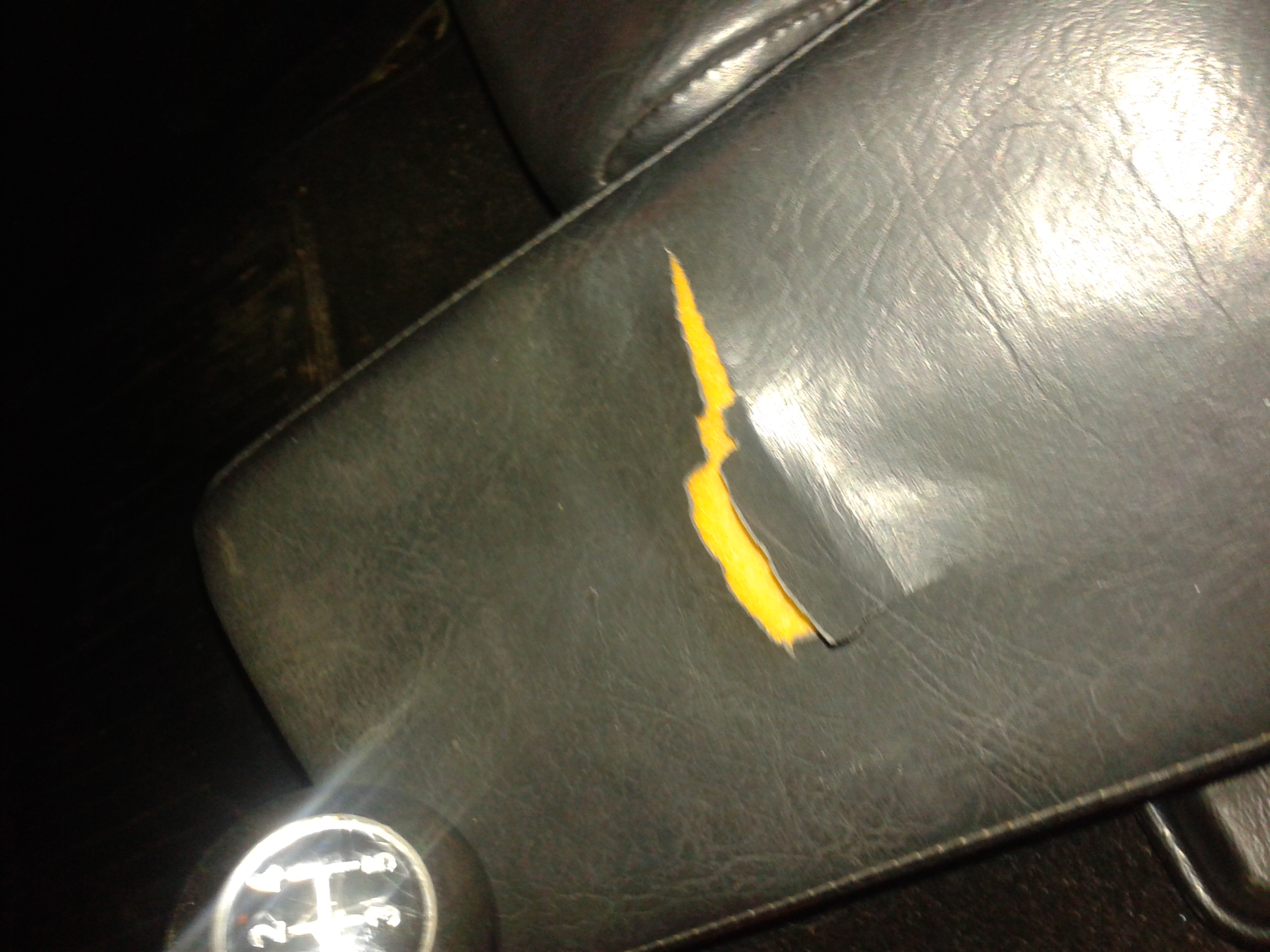

krazykonrad   :wttc:   Dec 6 2013, 05:39 PM
Ferg   Paintless dent guy can certainly take care of thos...   Dec 6 2013, 05:41 PM
