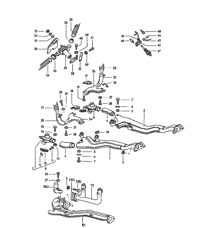

But my question is, what if any tin pieces am I missing in these pictures.

Got the scanner working. I circled the pieces I think I need.Attached Image
Will have to crawl under and look closer when I put the t-stat bellows and cable roller in.

QUOTE(rmdinmd @ Dec 6 2013, 02:31 AM) *
24 you probably have - it is hidden between the oil cooler and the case,similar to 17 on the other side, under the top tin. Something to keep in mind about 12 is there are different versions for tail shift and side shift.
I bet you are missing 17 and 18 below, to seal the heat. Also, I think 2 (?) of 26. It looks like you are missing 20 and 22, maybe 24 and 25?
