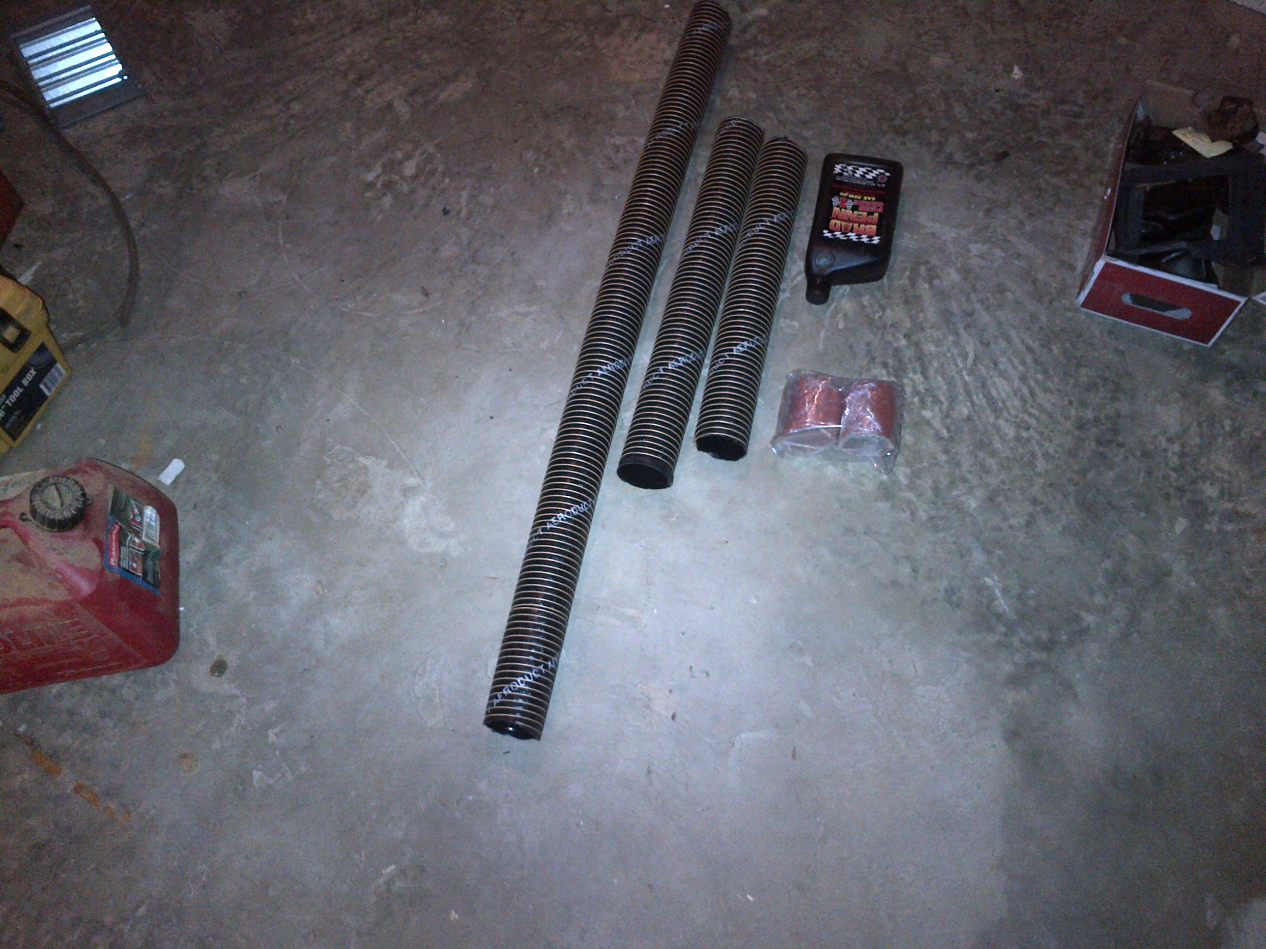

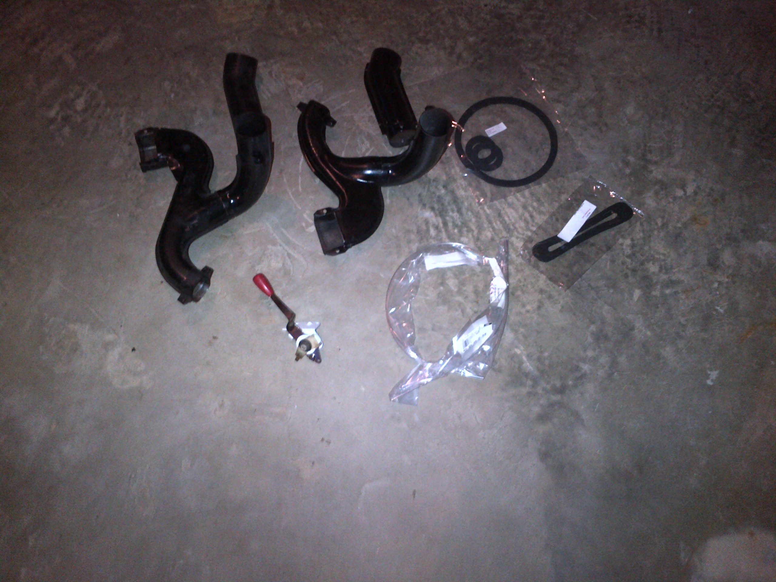

attached are some pics of what I have gotten. I am aware that I may be missing a hose and a seal for the fresh air box, sending out a request for info to supplier; figure it is holiday season and things happen.
Attached Image hoses, the reddish ones go from the heater flap to the long behind the seats? I know two of the black ones connect the blower to the down pipe on each side.
Attached Image heater tins I have. waiting on HE and modified pieces from tangerine. then will know if I need to get flapper, at least one comes with kit. Also getting the 2 pieces of tin from Ericoneal, so I might a shot of getting heat for xmas. (IMG:style_emoticons/default/biggrin.gif)
heater lever, cable and have other little pieces as well (nuts, seals)

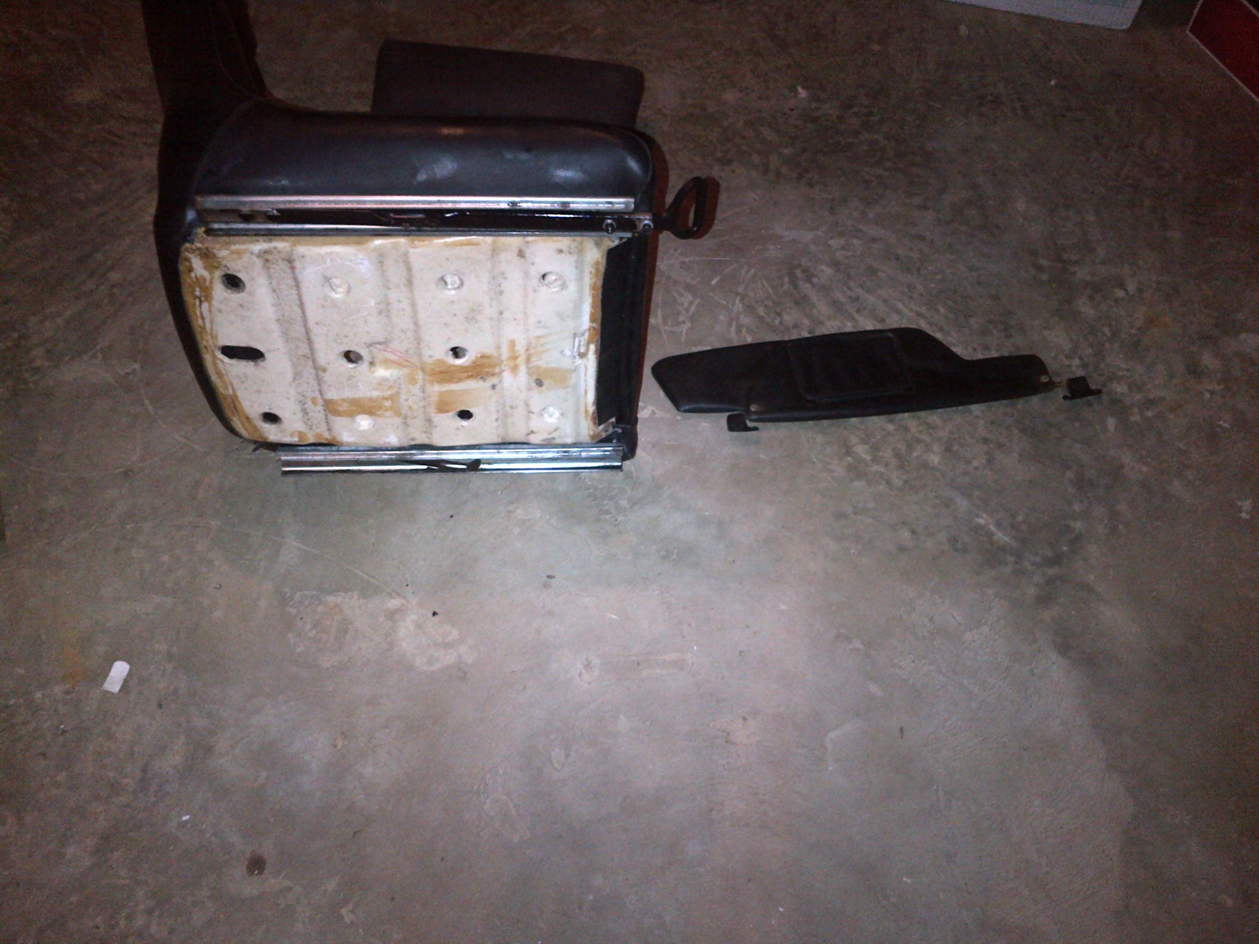

Attached Image and added a second set of slides to orig seat so it and the rally seat can be swaped without haveing to swap parts. found a passenger sun visor to replace one missing.

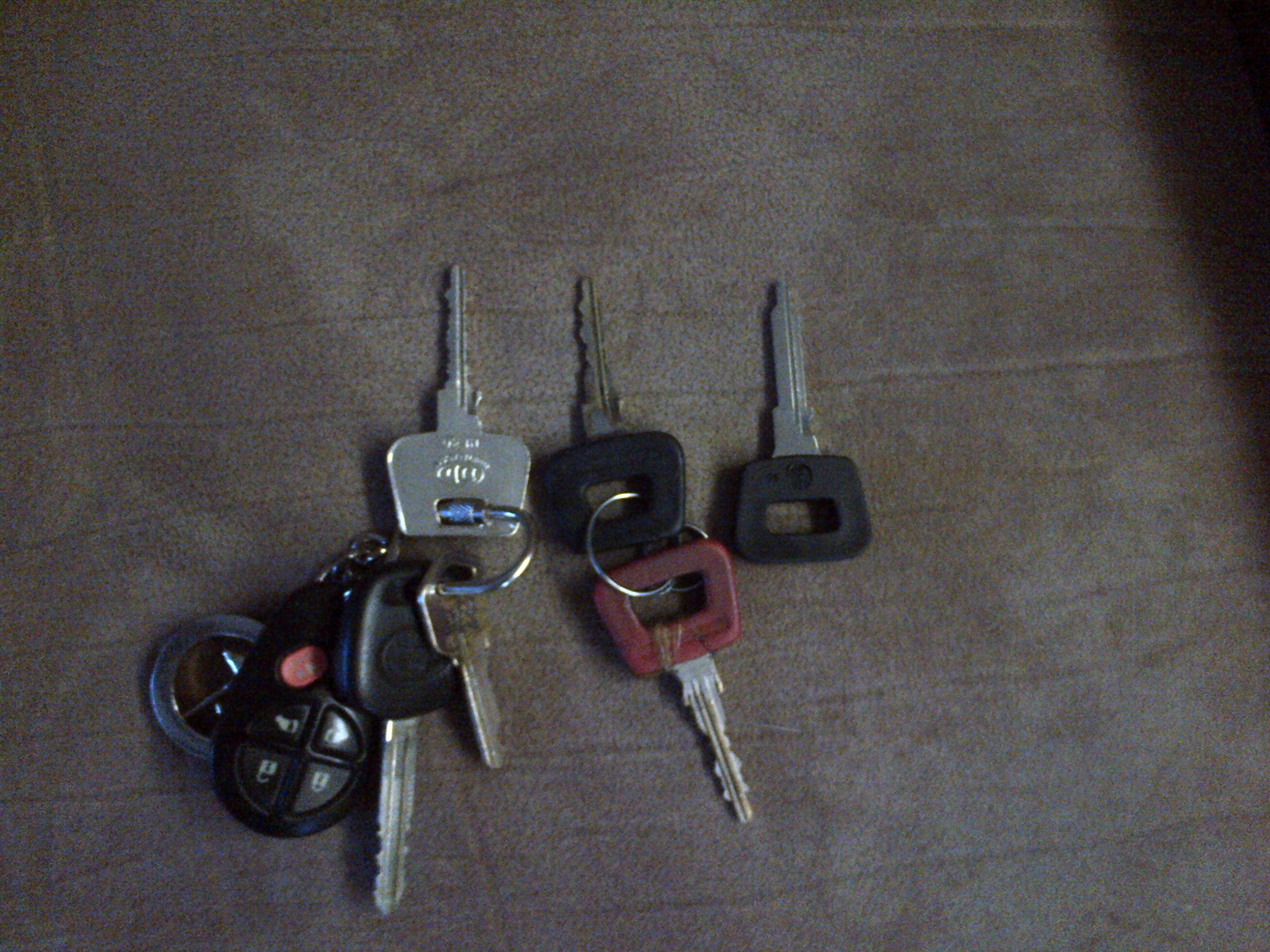

Attached Image The key I got with car looks really funky, almost serated (on the left), so I got some locks that had a key that looks "normal (center) and some blanks and plan on rekeying my locks and getting new keys cut. right know the key I have only works in the ignition, I figure it would be nice to have one key work them all. I have found the rekeying thread on here. tons of info and advice here.
