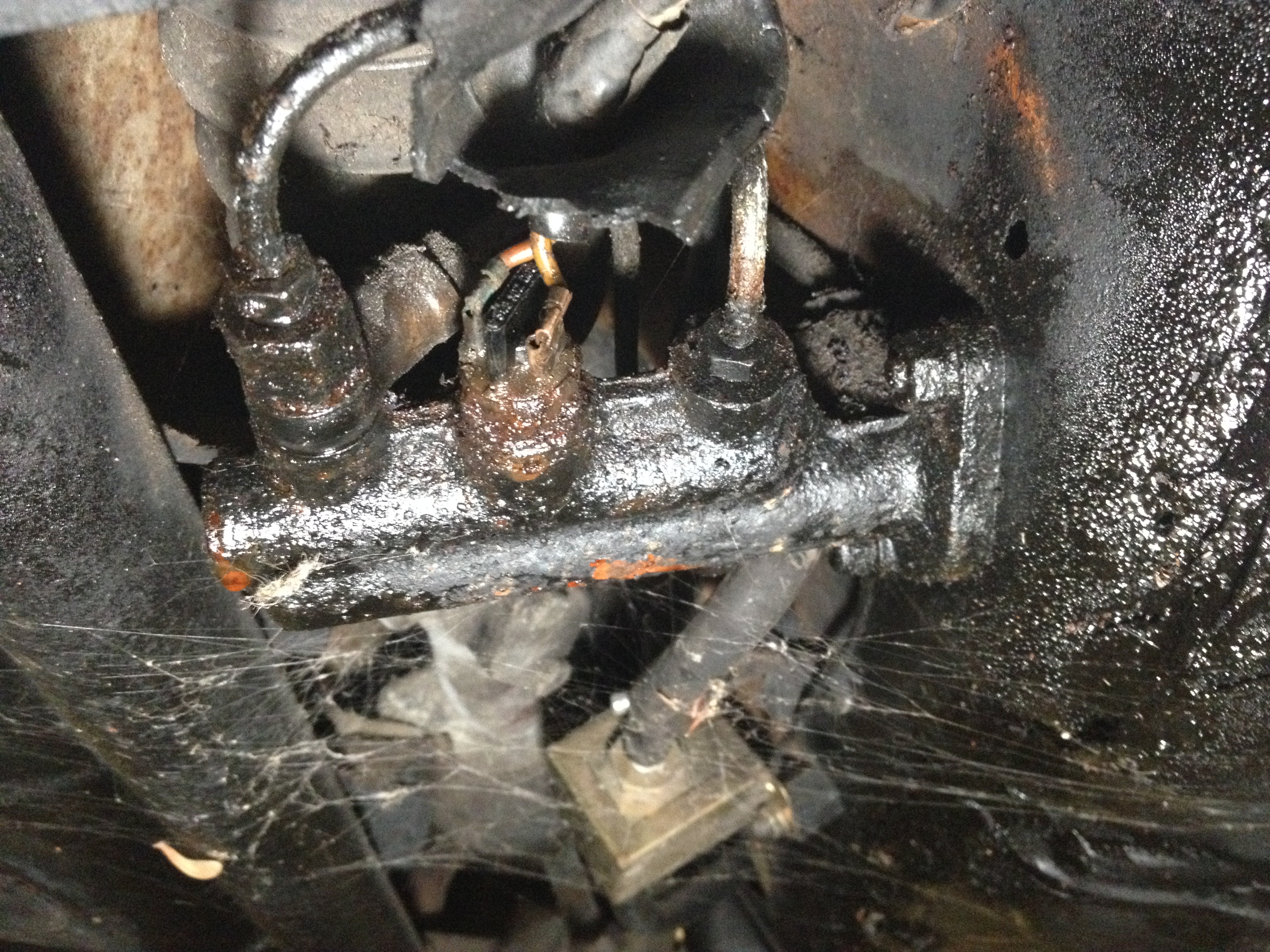

Is in in the middle, between the two fluid lines?
post Dec 9 2013, 09:22 PM
Resident German
Posts: 42,469
Joined: 21-January 03
From: Oakland, Kalifornia
Member No.: 179
QUOTE(1972 914 2.0 @ Dec 9 2013, 07:14 PM) *
That looks about right, can you push it in?
PS: Also looks like it's leaking, which would explain why the light came on ...
1972 914 2.0
post Dec 9 2013, 09:35 PM
Posts: 74
Joined: 9-December 13
From: United States
Member No.: 16,745
QUOTE(SirAndy @ Dec 9 2013, 08:22 PM) *
Well I tired pushing on it with a big screwdriver (then tapping the screwdriver with a hammer) and the little black button doesn't seem to want to move. What do you suggest?
P.S. It's a pretty slow leak, no drips no puddle. I'm thinking about swapping it out with a 914/6 until that I have.

toolguy   little button just under the front of the handle m...   Dec 10 2013, 02:50 PM
1972 914 2.0   little button just under the front of the handle ...   Dec 10 2013, 02:57 PM
sfrenck   This pic (bad focus) shows the push button switch....   Dec 10 2013, 03:25 PM
1972 914 2.0   This pic (bad focus) shows the push button switch...   Dec 10 2013, 03:31 PM
Dave_Darling   It's just above the floor pan, on the crossmem...   Dec 10 2013, 04:01 PM
wndsnd   17 MM are correct from the factory buy you might h...   Dec 10 2013, 04:56 PM
