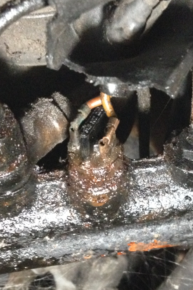

The b is on the guage indicating the lights are brake related not flasher or indicator related.
It is possible your master cylinder has been replaced and no longer has the switch. The button would be where the 2 wires plug into the mc. If has a little rubber boot. If you don't have that you probably just have a small phenolic barrier to keep the wires separate.
You would have to trouble shoot the circuit differently.

Well I don't think its been replaced, and the hardware is identical to the OEM 914/6 unit that I have. Ive been pushing in the little black rectangle between the connectors (see attached photo) is that what you are referring to?
