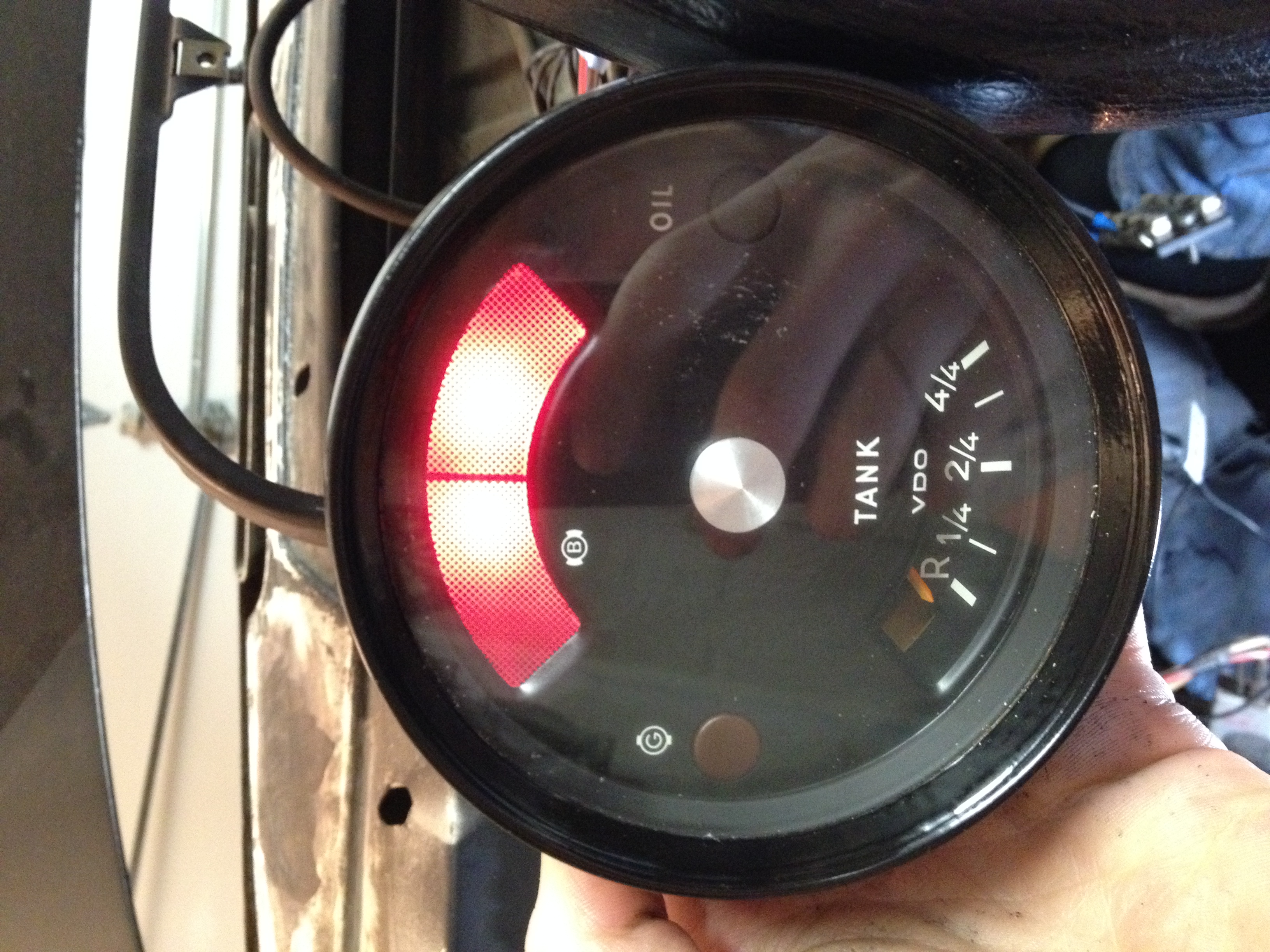

post Dec 9 2013, 07:32 PM
Posts: 74
Joined: 9-December 13
From: United States
Member No.: 16,745
QUOTE(SirAndy @ Dec 9 2013, 06:23 PM) *
QUOTE(1972 914 2.0 @ Dec 9 2013, 05:20 PM) *
No...this is different. These are Hazard indicator lights. Only available on 70-72 models. I am aware of the brake warning light, that is different.
Then post a pic of those "dedicated Hazard indicator lights" on your early car.
Glady, Here ya go...
post Dec 9 2013, 07:35 PM
Resident German
Posts: 42,469
Joined: 21-January 03
From: Oakland, Kalifornia
Member No.: 179
QUOTE(1972 914 2.0 @ Dec 9 2013, 05:32 PM) *
Yupp, as i said above, the MC pressure warning uses the same bulbs to indicate a pressure loss.
That goes for early cars too ...
