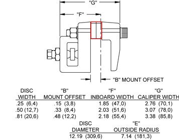

I would like to get a dedicated parking brake caliper. I've seen them but not big enough to fit over my 930 rotor.

QUOTE(Mike Bellis @ Dec 12 2013, 02:03 PM) *
Use one of the Wilwood spot calipers and create a thicker spacer to accommodate your rotor. I've got a place near me that can waterjet a spacer in pretty much any profile.

QUOTE(tomeric914 @ Dec 12 2013, 11:10 AM) *
YES!!! That's what I need.
