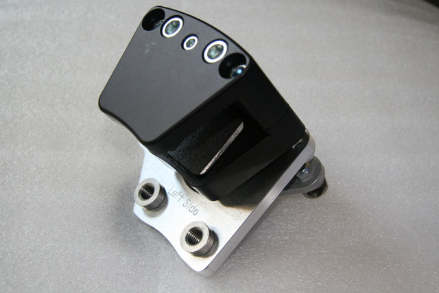

Ipsco make a nice spot caliper for Pantera and Vipers that are small and light. Good design for clamping. Will go from .750 on up to 1.25 inch thick rotor.
The Brembo spot parking brakes used on Ferrari are really light but they are kind of bulky. They are fairly cheap to purchase though and cable operated.

Eric_Shea   2lbs. 12oz. light enough? 38mm pistons are the pe...   Dec 11 2013, 02:32 PM

Mike Bellis   I would like to get a dedicated parking brake cali...   Dec 12 2013, 12:03 PM
tomeric914   I would like to get a dedicated parking brake cal...   Dec 12 2013, 01:10 PM
