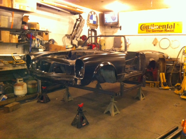

After several years of sitting mounted to my Celette the Mercedes is finally off. I have to add a removable tong and axle to this frame and haul the car to e-coat.

rick 918-S   After several years of sitting mounted to my Celet...   Dec 14 2013, 08:11 PM
iamchappy   Glad to see it getting done, that car has been app...   Dec 14 2013, 08:45 PM
