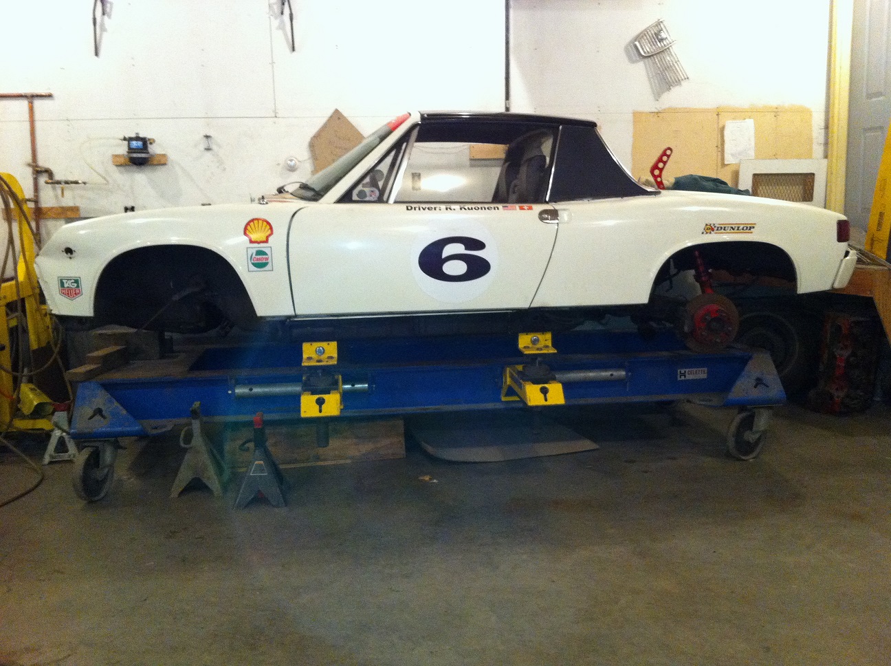

Now on to the car. I have it home now. My son Aric and I spent some time doing forensics on the chassis. We dropped the suspension and started removing some of the bolt on stuff that will have to be cleared in order to repair the chassis.
I plan a full on documented chassis rebuild showing the process involved in determining how and where to pull, what to remove and the importance of proper technic when splitting panels welding things back together. To some this may be basic but I get a lot of questions about chassis repairs and felt it would be a good place to start a discussion.
For now, here's the car:

Ok, I finally have the Mercedes off the Celette. I have limited space and with all the snow I can't move the Celette to the other garage. So I spent all day yesterday removing the Mercedes and mounting the 6 on the pinch weld clamps.
I have other cars ahead of mine so I won't rent the fixtures to start the repairs until around the end of March but at least the car is sitting on the bench.
