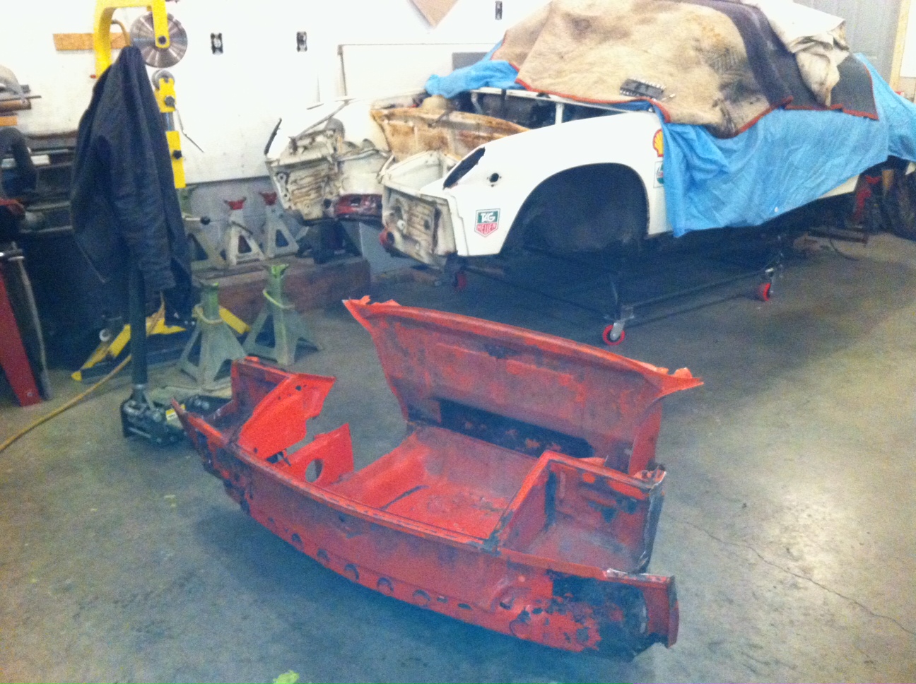

I'm collecting parts and trimming the donor panels in preparation of the big day. I have every intension of having scotty b here during the big pull on the Celette. We have been chatting about this for some time. He seems to think I can teach him something.
Mark your welcome to come out too. I have a big house with extra beds. Spend a long weekend. It will be a great time.
The truth is I need Scotty's metal finishing skills. I absolutely have to save both inner wheelhouses without the use of body filler. Between the two of us I'm confident it will be done. This is key to the success of this repair.
It will be a waste of time to have him come if I'm not ready to fit parts. Lots of trimming to do to clean up all the attachment flanges on the parts shown here but I have a nose panel trunk floor and bulkhead. After I'm done trimming the panel I will bring it to the blaster and have it stripped clean of all the orange paint.
This clip will look a lot different after it's trimmed.
