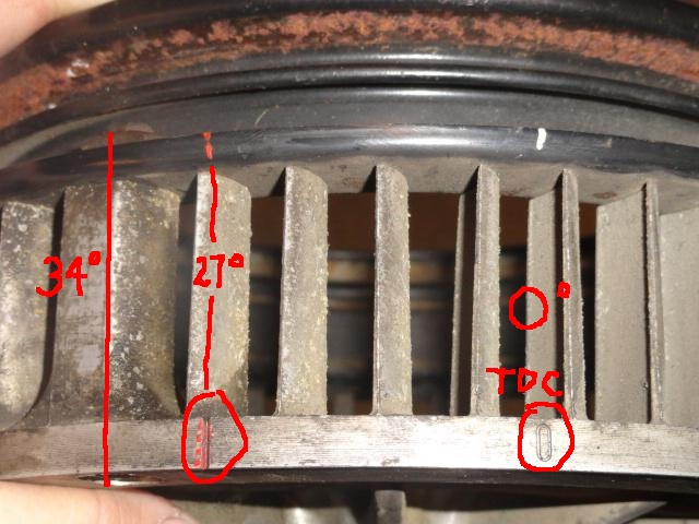

Zero is TDC. The hash mark on this fan is 27° BTDC. For a 2.0L, you'll want approx 34° at 3500 rpm. Depending on a couple factors, 34° may be too much advance. You don't want any pinging, so be prepared to retard if necessary, then make a new mark for your specific requirements.
Read this Pelican article on timing ... Click here

Bob L.   That is not the flywheel, it's the cooling fan...   Dec 16 2013, 01:51 AM
kkid   That is not the flywheel, it's the cooling fa...   Dec 16 2013, 12:23 PM
euro911   Zero is TDC. The hash mark on this fan is 27° BTD...   Dec 16 2013, 02:42 AM
Bob L.   Mine has only one mark for 27deg BTDC. I have read...   Dec 16 2013, 01:14 PM
