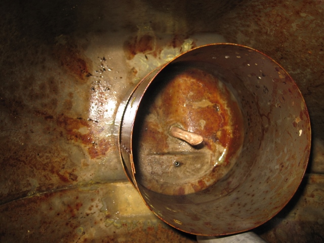

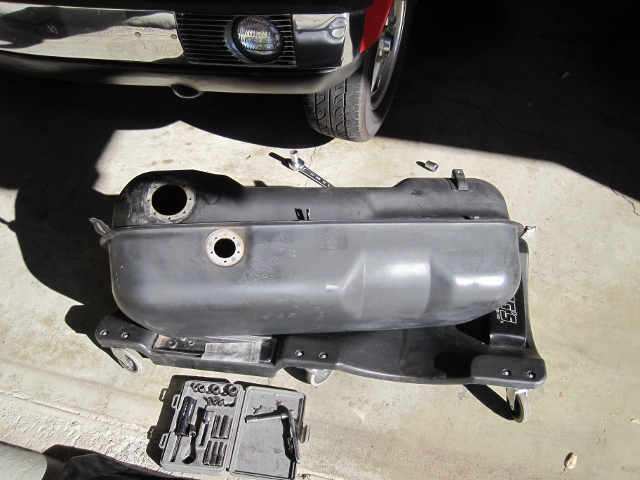

Pulled the gas tank today and sent it to a local radiator shop in my area.
Will watch it to be cleaned tomorrow. So I can take it home and install as soon as I pick it up.
Attached ImageAttached ImageAttached Image
