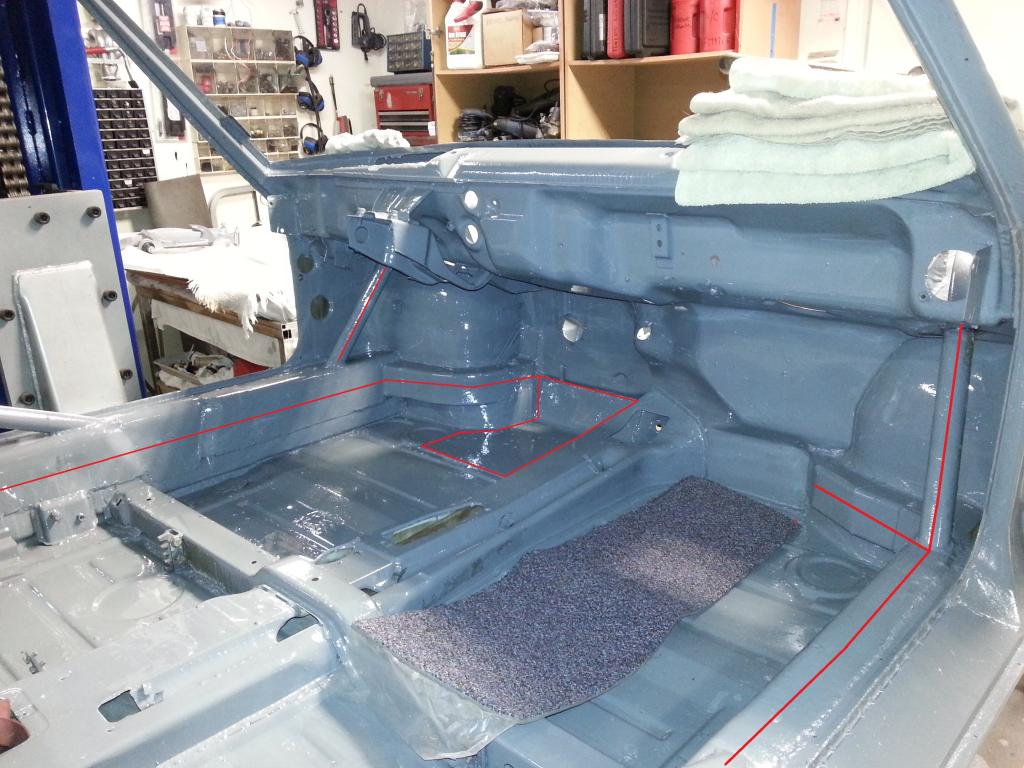

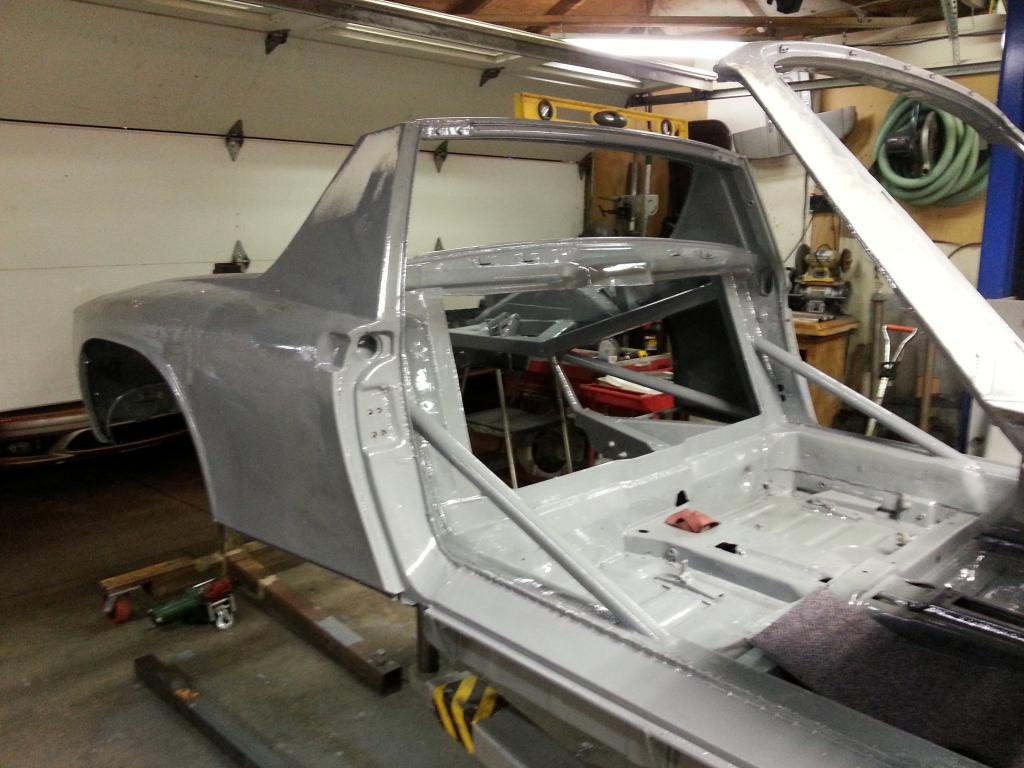

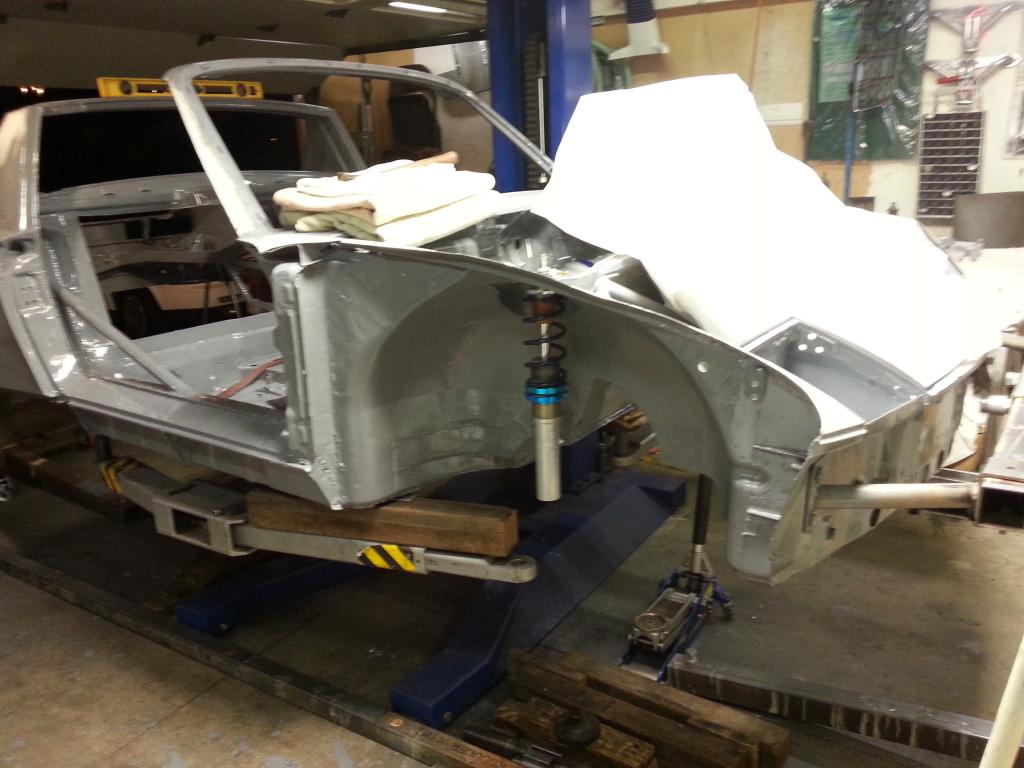

I finely got my car epoxy coated, did it myself and will never do it again. Used Por-15 and its messy. The area outlined in red is where the PO added some nice framing. The quality of the work is clearly better than I could have ever done. That's the reason I bought this project along with the 996 suspension. Got a long way to go !!!!
