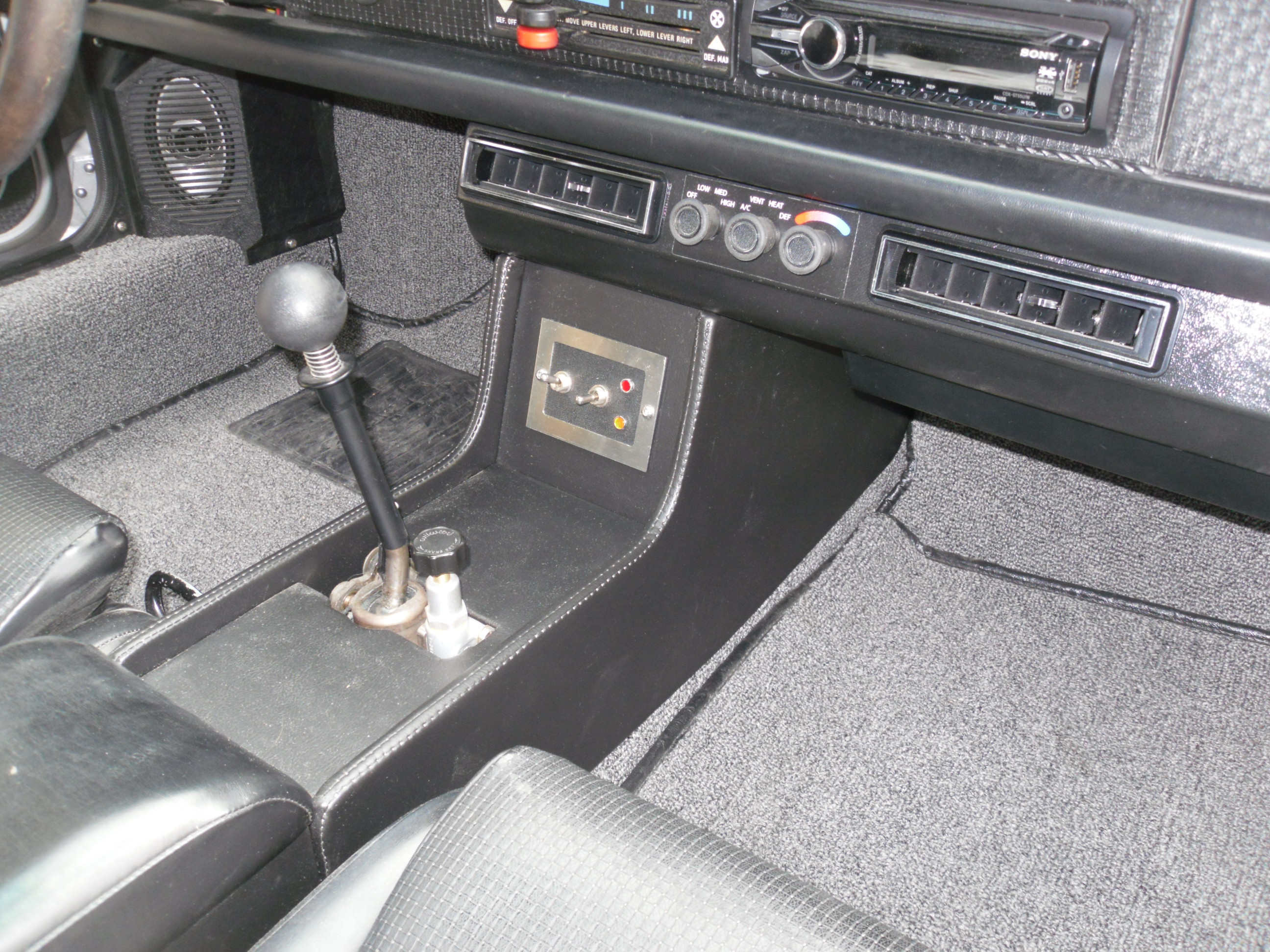

I would like to add heat and defrost to my Subaru conversion, but I'm not sure the best way to do it. Now, I'm no expert on the ventalation system of these cars, but I was hoping to have something simple like 2 discrete motors. One for the vents on the dash, and another for the defrost.
The stock heat blowers are intact on the car, but I don't believe they're hooked up at all, since the PO had a SB350 installed. That motor is going bye-bye, and I'm not sure the best way to add something to replace it. I don't need fire shooting out of the vents like my Land Rover, just enough to get the windscreen clear and take the edge off of a cool night.
I see a few aftermarket blowers that I can put in-line with the heat tubes, but how should I GET the heat? Is thee a way to do it from the water in the radiator?

I have seen the under dash ones. Renagade, Pelican and what not sell them but its a whole kit compressor and all. I would be happy with something like that if I could use the compressor from the subaru enigine.

I got my under dash unit from Hot Rod Air (now defunct) and didn't have to buy a "kit." My under dash has heat as well.

BIGKAT_83   Like mine here. Both heat and AC. Still have to f...   Dec 16 2013, 10:22 PM
