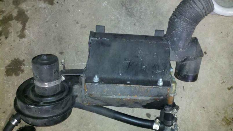

I have a unit that came in a Rotary conversion. I think it's similar to the fresh air vent Mark is making. Except it had oil & water filtering through it. It also used the stock fan. Kind of fugly but very functional. Also pretty easy routing as it sits in the engine bay. So short lines going to your motor.

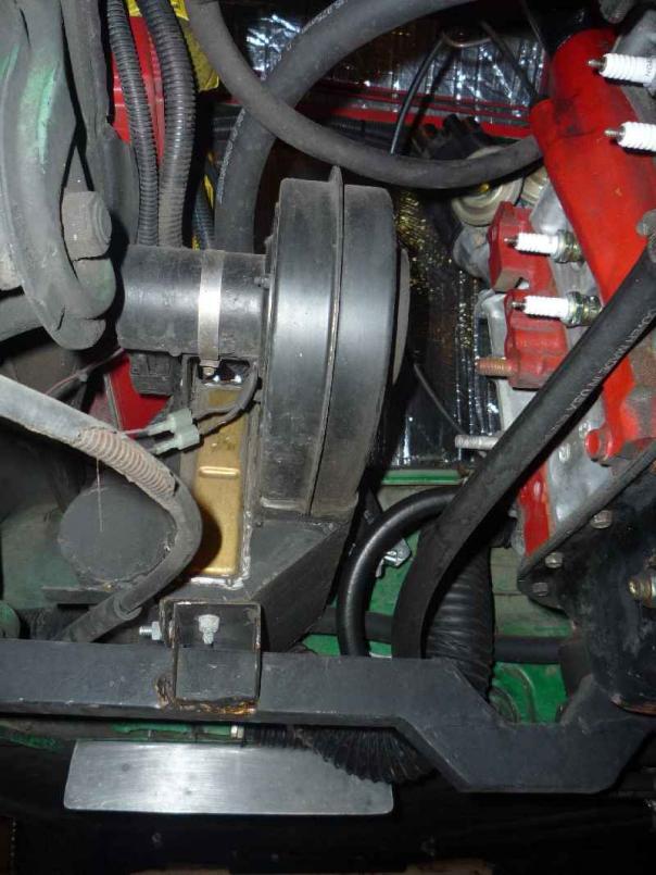

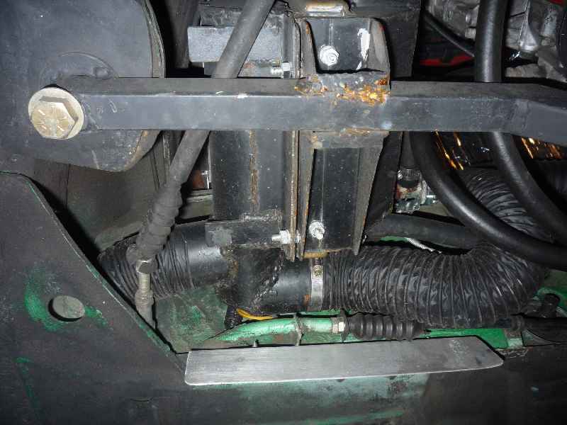

Mike Bellis   I did an oil cooler in the fresh air box. I did a ...   Dec 16 2013, 09:34 PM

Mike Bellis   Here's my heater thread... http://www.914worl...   Dec 16 2013, 10:23 PM
