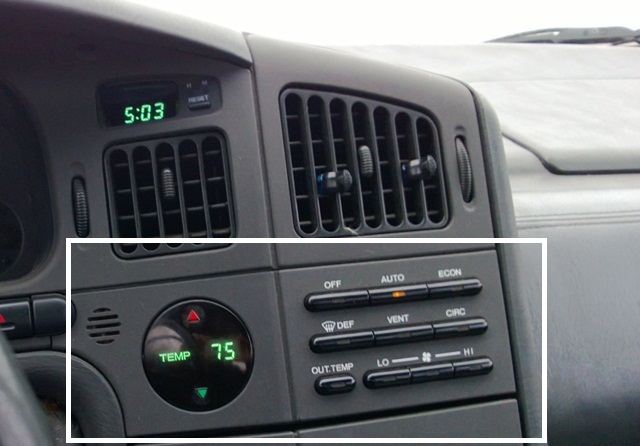

I saved all of the SVX hvac system hoping to use it and the wiring harness. Even the dash vents and dash top and stuff just to understand how it worked before....would take a lot of work to integrate into the 914 but will try to figure it out someday. I'd hide the control panel somewhere so you can't see it...under the center console I have to build or the drivers side arm rest....
It's just this part....

QUOTE(Chris H. @ Dec 18 2013, 08:47 AM) *
I'm thinking that's the way to go also since I've picked up a low mileage, working in every respect SVX. It would require alot of under dash welding of tabs, etc. for mounting and such but certainly doable. The SVX has quite the alluring dash setup- not the traditional 914 look by any means but I'm not looking for a restoration- I'm looking for a comfy, full functioning coast to coast cruiser. Mid engine, water cooled 300 hp GT car... (IMG:style_emoticons/default/aktion035.gif)
