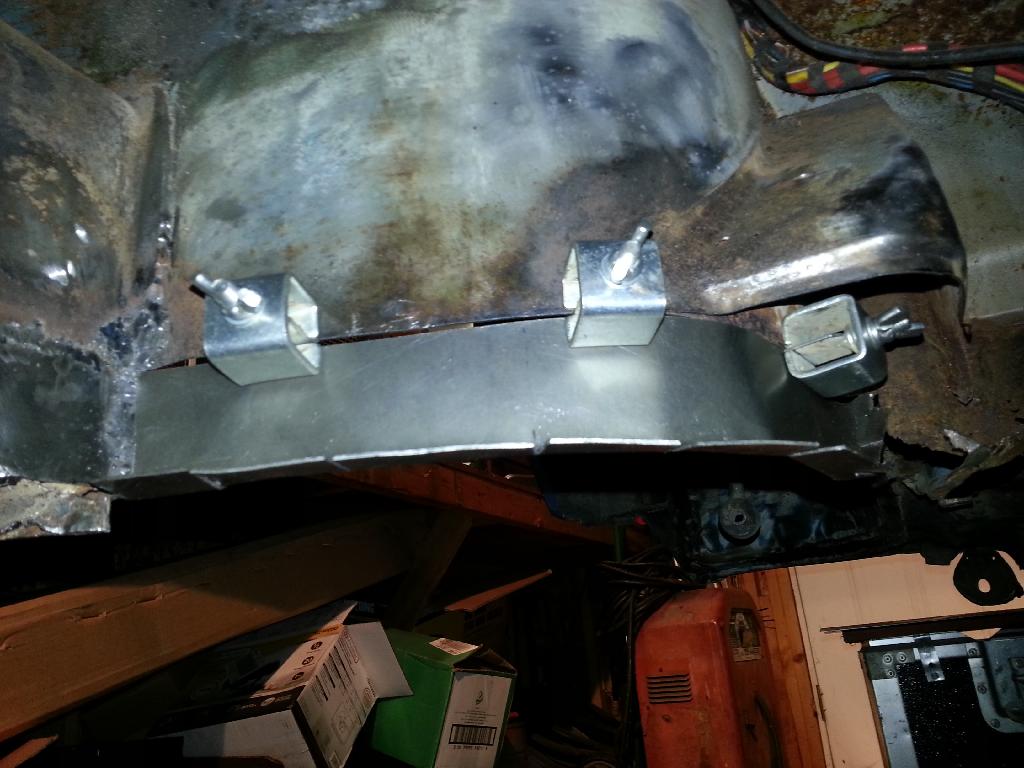

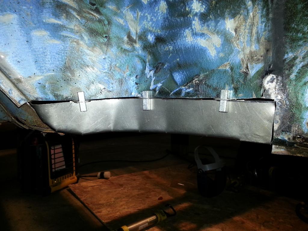

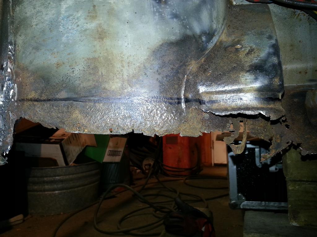

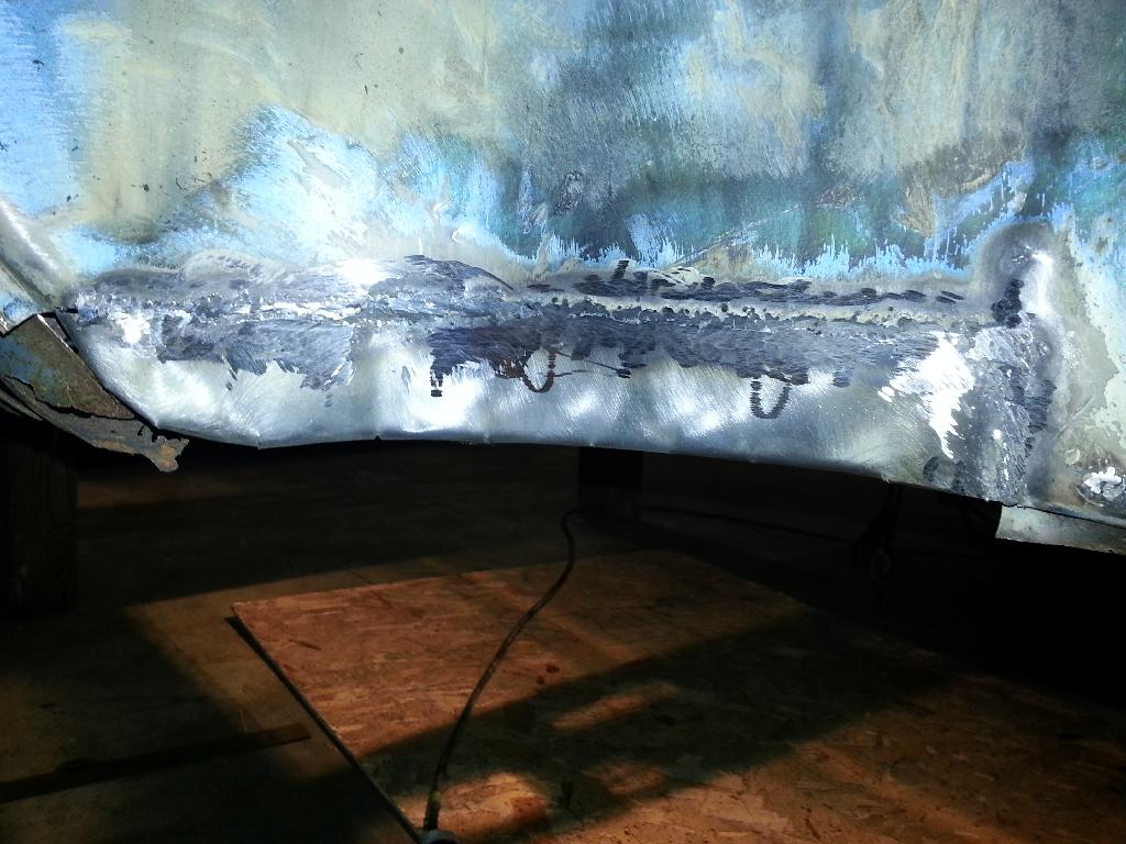

So I'm diving in to this last area of floor pan attaching sheet metal. There's not much left here to help me fabricate replacement. I'm starting with the backside of the wheel house and using the passenger side as a template (they appear to be mirror image). There's a sliver of the folded seam from the factory where the wheel house joined the floor pan. Reproducing that exactly far exceeds my skills at this time so I'm just using right angle flanges. I've left those a bit longer than the usual 1/2" so I've got extra metal to work with when it comes time to put the pans on. The bend in the wheel house is a little complex, almost an S curve but it fabs up pretty well. What is handy is being able to weld both sides. This should add strength in a high stress area. Next I'll tackle the front metal behind the peddles and tunnel. I haven't look really close but I think this can be done with one large strip. I'm also thinking that I'll overlay the new metal on treated old with spot welds. That way I'll have the brake master cylinder mount in the exact position (it's still there but barely) and I'll have a better sense of the gentle curve from "firewall" to floor pan. All this is subject to change of course.
