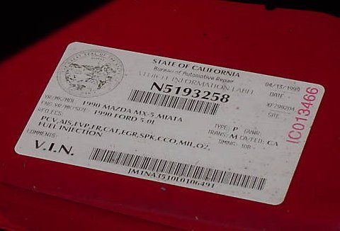

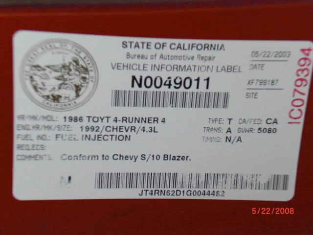

QUOTE(2mAn @ Dec 17 2013, 04:38 PM) *
As far as a TDI goes it depends in which year. Technically it would never be California legal because you can't swap motors from different manufacturers and there was never a diesel Porsche made, so you're SOL with the 76. Sucks because it would be fun
Yes it is legal to swap an engine from any manufacturer.
It must be the same year as the car OR newer.
It must have ALL smog equipment from the model year engine
A smog referee station must inspect the car for compliance.
The car is issued a sticker from the Bureau of Automotive Repair stating the new engine and smog requirements.
If the car is 1975 or earlier, you will be exempt from periodic testing.
Sticker looks like this...
(IMG:http://www.914world.com/bbs2/uploads_offsite/forums.rennlist.com-10496-1387331611.1.jpg)
(IMG:http://www.914world.com/bbs2/uploads_offsite/i203.photobucket.com-10496-1387331699.1.jpg)
(IMG:http://www.914world.com/bbs2/uploads_offsite/bringatrailer.com-10496-1387331782.1.jpg)
