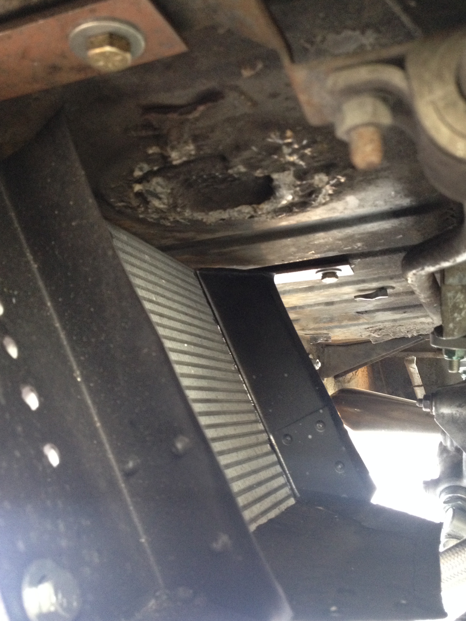

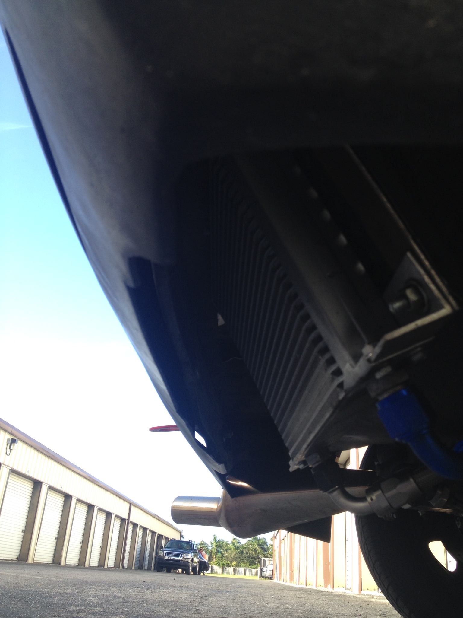

These pics are how I mounted the cooler up.
I want it to stay in the rear because of my fuel cell (its tight up there).
Thinking about the hole saw to get some air out.
Im up for advise before I cut more of my car up.

Seabird   I like the installation, why not just add a fan to...   Dec 22 2013, 12:29 PM
Jetsetsurfshop   I like the installation, why not just add a fan t...   Dec 22 2013, 01:03 PM
Seabird   Check out the first picture. Its kinda "wedg...   Dec 22 2013, 01:21 PM
brant   I think the fan will help too although some say a...   Dec 22 2013, 01:50 PM
Jetsetsurfshop   I think the fan will help too although some say ...   Dec 22 2013, 05:07 PM
Racer Chris   I disagree about adding the fan, unless it moves a...   Dec 24 2013, 11:32 AM
Jetsetsurfshop   Duct work   May 27 2014, 09:35 AM
veekry9   Duct work Remarkably similar to the P51 belly s...   May 27 2014, 08:35 PM
Jetsetsurfshop   Tubing   May 27 2014, 09:36 AM
Jetsetsurfshop   To the cooler. There is also a air duct on the low...   May 27 2014, 09:38 AM
Racer Chris   What does the inlet side of the cooler look like?   May 27 2014, 10:15 AM
Jetsetsurfshop   Here you go Chris. Screens are not installed yet i...   May 27 2014, 10:26 AM
Racer Chris   I meant where the ducts end at the face of the coo...   May 27 2014, 10:39 AM
Jetsetsurfshop   I meant where the ducts end at the face of the co...   May 27 2014, 10:58 AM
brant   nice work.... I built something similar for my tr...   May 27 2014, 11:05 AM
Jetsetsurfshop   nice work.... I built something similar for my t...   May 27 2014, 11:23 AM
brant   I think your lack of the 90 turn is only going to ...   May 27 2014, 12:01 PM
Seabird   I was under the impression that the tumbling air u...   May 28 2014, 07:51 AM
Jetsetsurfshop   I was under the impression that the tumbling air ...   May 28 2014, 09:40 AM
Seabird   I was under the impression that the tumbling air...   May 28 2014, 09:41 AM
brant   you have a great bunch of teeners out there... tim...   May 28 2014, 10:26 AM

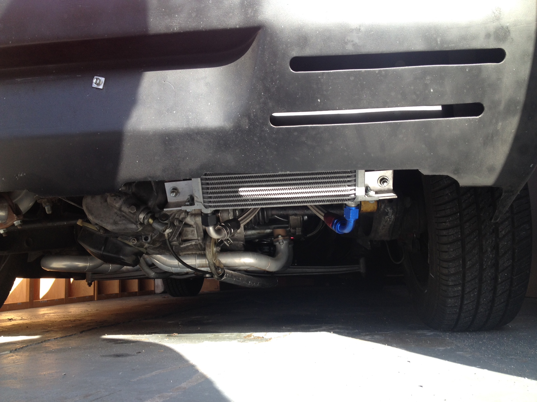

Jetsetsurfshop   New bumper exit. I think I've been building up...   Jun 15 2014, 09:02 AM
ablesnead   Shane that screening reduces airflow about 30 perc...   Jun 15 2014, 09:26 AM
Jetsetsurfshop   Shane that screening reduces airflow about 30 per...   Jun 15 2014, 09:34 AM
Jetsetsurfshop   Took the screen off and added brackets to hold the...   Jun 15 2014, 11:18 AM
Seabird   Took the screen off and added brackets to hold th...   Jun 15 2014, 05:30 PM
Jetsetsurfshop   Took the screen off and added brackets to hold t...   Jun 15 2014, 05:56 PM
Seabird   Cool, I am going to try and bring mine too. Oil, ...   Jun 15 2014, 06:12 PM
brant   Shane, in the olden days when 914's ruled th...   Jun 15 2014, 04:51 PM
Jetsetsurfshop   Brant, Would you change anything on your oil coole...   Jun 15 2014, 05:36 PM
brant   Brant, Would you change anything on your oil cool...   Jun 16 2014, 11:29 AM
brant   here is my EX race car... the cooling is great I h...   Jun 16 2014, 05:16 PM
