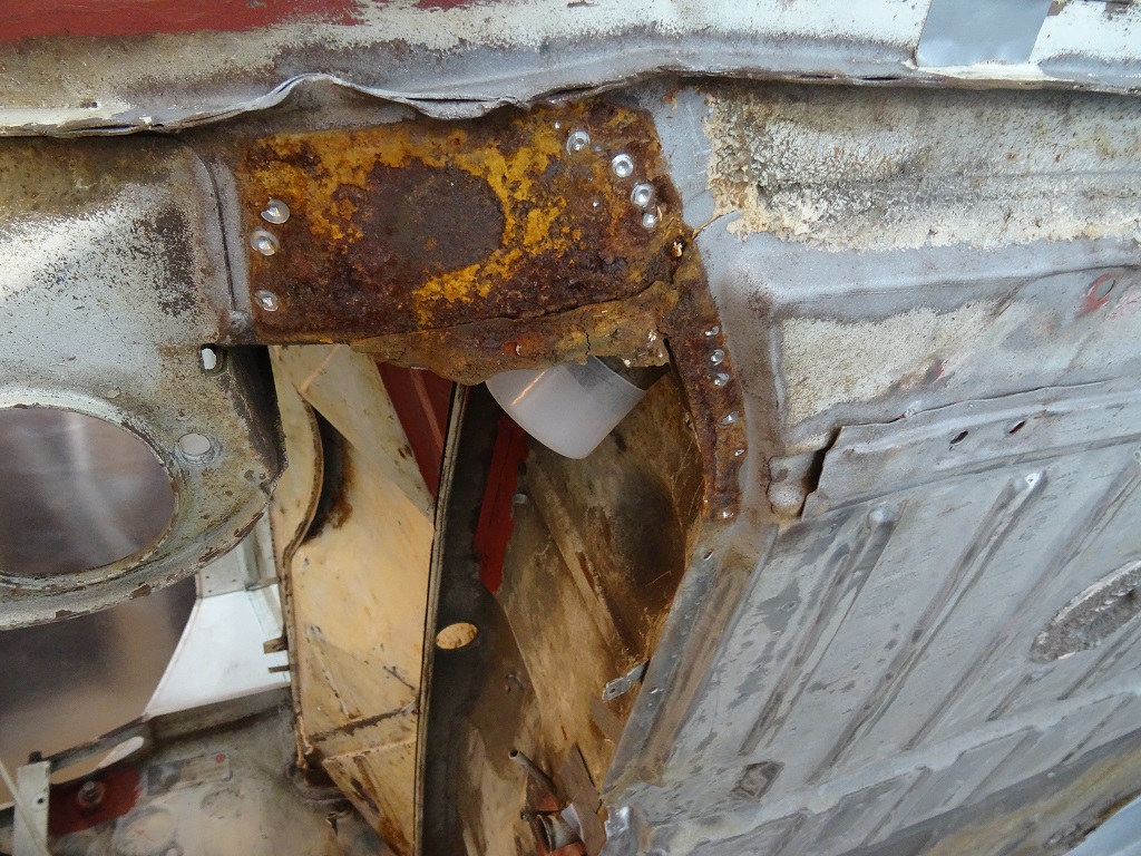

And this is what it looks like under your rear lifting points... (IMG:style_emoticons/default/welder.gif)
