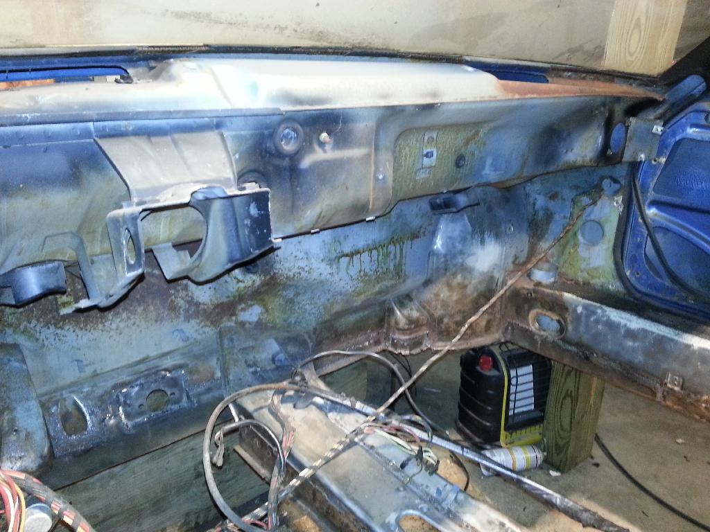

post Dec 23 2013, 06:22 PM
Posts: 291
Joined: 30-September 13
From: Middle Tennessee
Member No.: 16,456
Today I got the upper pad, lower pad, steering wheel, steering column, steering rack and dash assembly out. I'm glad I did! There's some rust invading the steel bulkhead below the right corner of the wind shield. Removing those parts went fairly well with no new wildlife to report. The mice had been nesting in the left vent, building up garbage around the wiring harness. But there's no indication of gnawing on the wires. Tomorrow I'm going to break up the wire bundles and discard every thing going to the front of the car. Nothing from the dash forward will ever need electrical so all that can be cut out. In fact, I don't think I'll even put the dash back in. Probably just fabricate a box for the instrument cluster and use the OEM console gauge cluster. Tomorrow I'm also going to clean all that sheet metal on the front bulkhead to prep for rust treatment.
