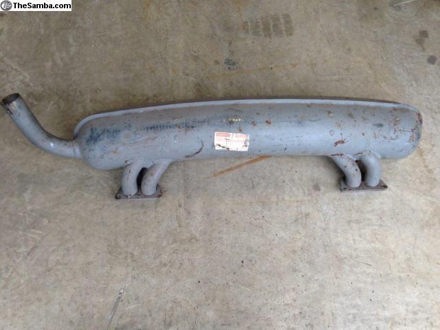

I too replaced a Monza that came on the car when I bought it. I purchased an OEM Leistritz muffler from the Samba, for $400.
I am much happier with the sound, and the look of the OEM.

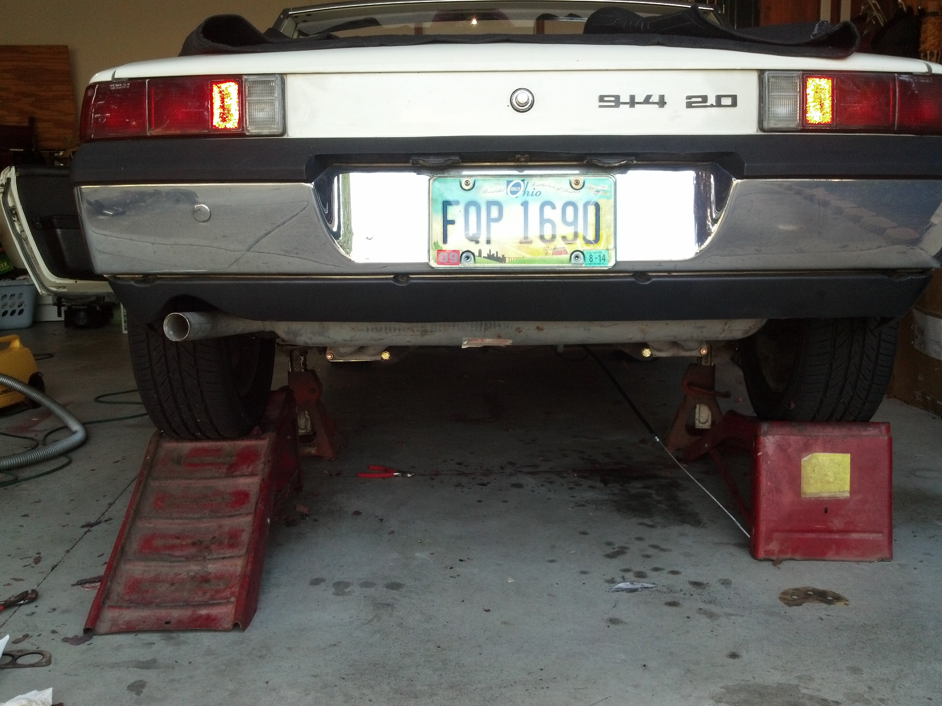

Montreal914   When I bought my 2.0, it had a 4 tips that I repla...   Dec 25 2013, 10:21 PM

jimkelly   and here is another muffler that would be a good b...   Dec 26 2013, 07:31 AM
Mblizzard   and here is another muffler that would be a good ...   Dec 26 2013, 09:33 AM
cary   Ditto on Jim's picture. That way you can go to...   Dec 26 2013, 09:35 AM
ThePaintedMan   I like that one too. In fact, if any of you guys m...   Dec 26 2013, 09:48 AM
