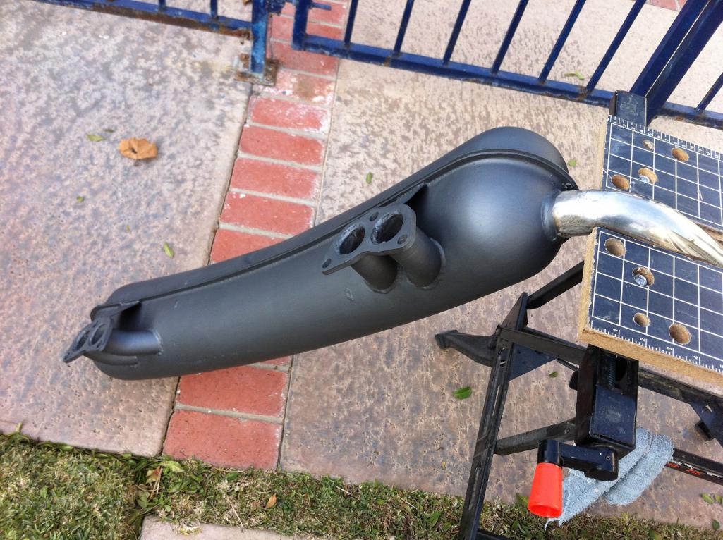

When I bought my 2.0, it had a 4 tips that I replaced with a Bursch. It didn't last (it was already old) and got very loud. (IMG:style_emoticons/default/icon8.gif)
So when I built my Djet 2056, I got a used Dansk (Craigslist $160) and refresh it using "Factory Manifold Gray" paint by the same company that does Por-15 and I'm very happy with the result. (IMG:style_emoticons/default/driving.gif)
Also, with the Dansk, you get a stainless steel tip. I really like this option because it's original, fits the valence, and it's quieter (as much as an air cooled can be). (IMG:style_emoticons/default/rolleyes.gif)
