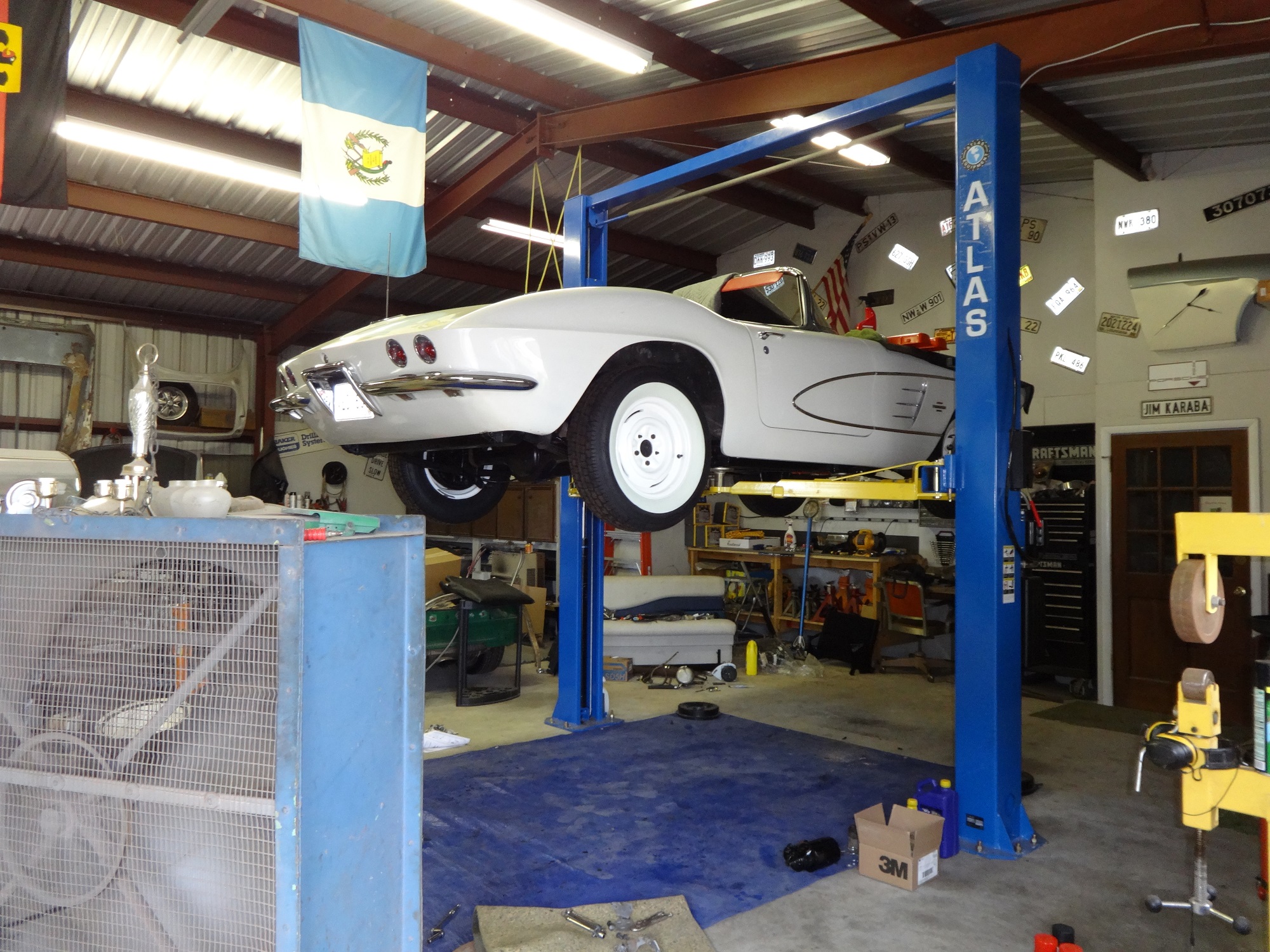

Here's my Atlas from GregSmith. Went up in less than a day. Very easy and works smoothly. I didn't need to go with a base plate model though because I have plenty of ceiling height, but I am sure they all have the same build quality. I had a friend help put the overhead beam in place, but I'll bet if I had the base plate model I could have done it all myself. The uprights are heavy but can be walked up by one person if determined (like I was). Once standing up they can easily be shifted into just the right position. I drilled the holes in the concrete once I had the posts in place and squared up.
