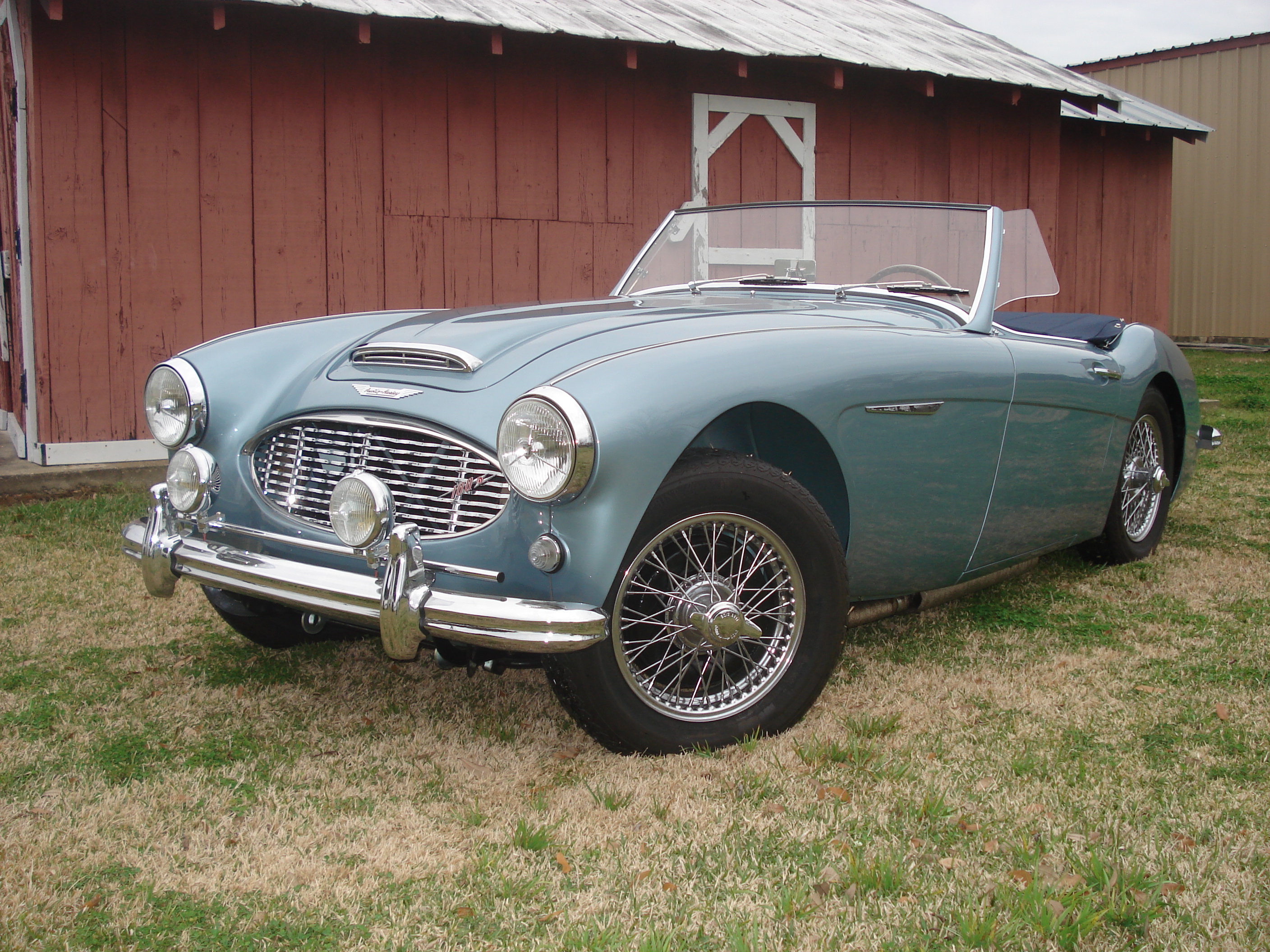

Yup, my last one was the original door of my 1953 Pre-A 356, but I let it go with the car when I sold it because I felt it should stay with the car. This is the original front fender from this car I finished last year.
