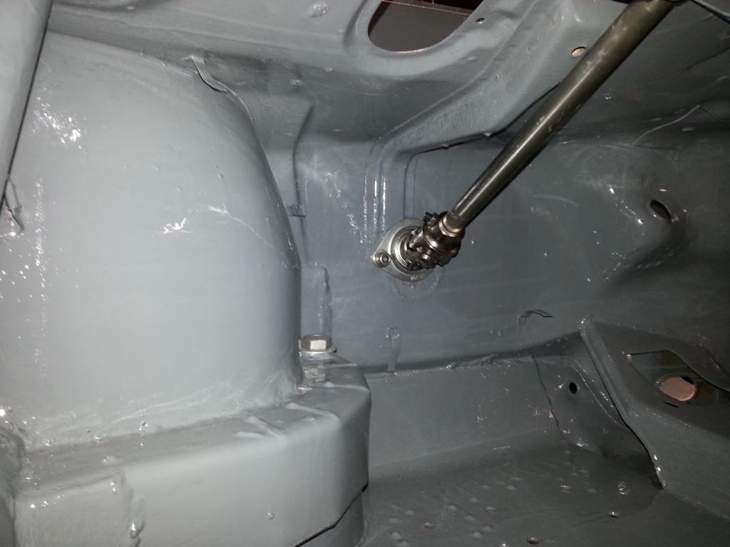

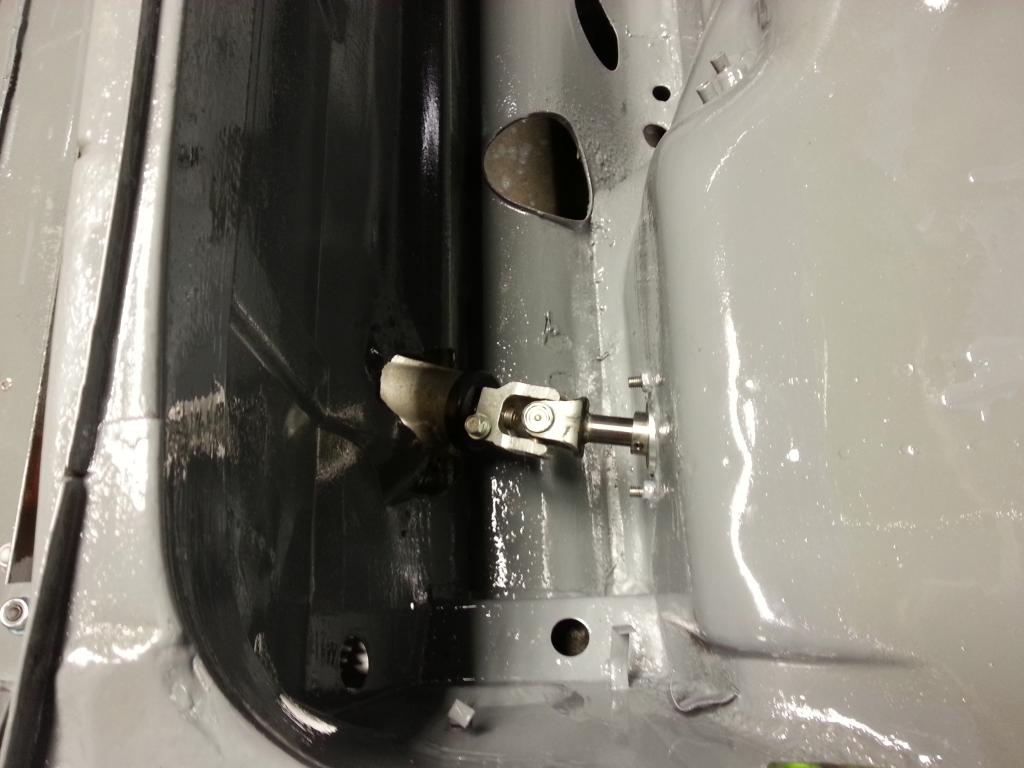

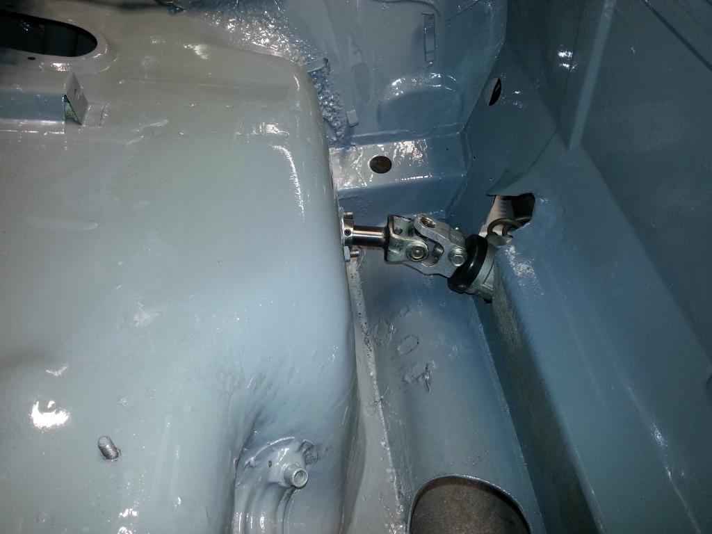

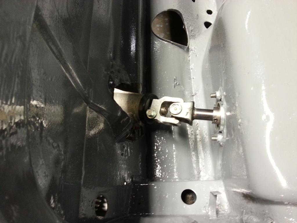

Still fitting parts, got the rack in and the steering wheel. I have now the ability to move the car around, that's good since I don't have much room in the garage.
